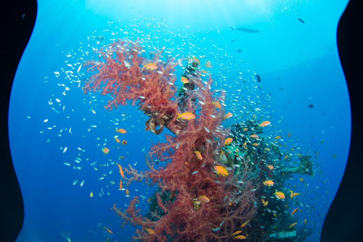

    Yesterday was my first UW shooting with my new Ikelite D7100 housing (2 DS161) and with Ikelite 8" dome port with 2.75" extension recomended by Ikelite for the Nikon 10.5mm.
    For some reason all my shots had my dome shade (sample attached).
    I know I can remove the shade, however, if its the recommended size shouldn't it fit perfectly? am I missing something?
    I have followed all manual instructions and I could not find any mention of this problem.
    I guess I did something wrong. Has any one ran into this problem with a similar setup?
    Thanks,
    Gal
  2. Can you post a picture of your port extension and dome please?
  3. Hi, Its the same as the one in the link in my post. The port was threaded snugly all the way to the extension.
    Gal.
    Sent from my Nexus 5 using Tapatalk
  4. He wants to see if you have the shade turned wrong, If its 90 degrees off, you will see the port.
  5. Ohhhh , of course it was assembled wrong.
    Thank you so much.
