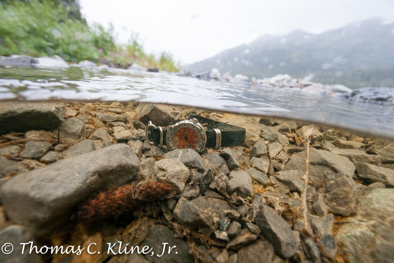

  7. I got the lens but the weather has turned nasty, over 2" (5 cm) of rain in the last 24 hours. The good news for me is that adult salmon should be up in some streams once the water starts to recede. I took advantage of a short break, only misting but still blustery (now is pouring again,) and shot in this stream that is only about 1 mile from where I live. Really too shallow for testing but I did these close-ups anyway. Two shots from same spot were at 15 and 31mm focal lengths. There is a tiny salmon fry in each shot - I did not see it when I was doing the shooting. The shot of my watch (@16mm) is even shallower - it is possible to see in focus behind watch to left and right of it due to field curvature.
    This test was done with the Seacam wideport. The housing was on the stream bottom. It was not very submerged even though a small diameter port. I used a 55mm port extension tube a.k.a. PVL. Shots done at f/8 with ISO 1600 in aperture priority. I used the zoom gear for the 17-40 lens; it required some stretching.

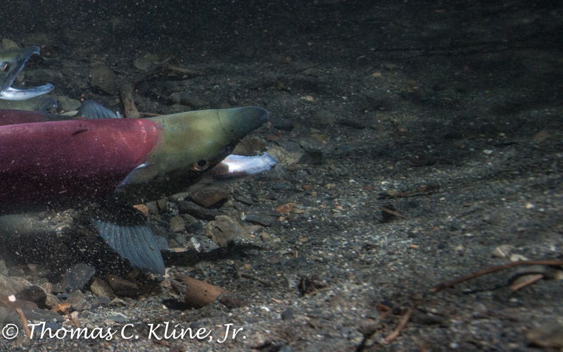

  8. The storm cleared and the precip led salmon up to the spawning area where I like to shoot. Got in these shots of Sockeye Salmon spawning yesterday evening. One pic shows the full frame while the other is a blow of the right side. The gravel in front of the male on the right end of the bunch is not sharp but is sharper in the background showing the curvature of field from the dome port.
    I used the Seacam Superdome with 55mm of port extension. 16mm focal length, aperture = f/9. Results look good thus far.
  9. Here is another image treated similarly from earlier in the day when more ambient light was present. The blowup in this case is on the left. The teeth of the male are critically sharp (blowup) but the scale pattern gradually gets soft going towards the left edge, but not all that bad. Also at f/9. I left the camera settings the same all day but did tilt the housing down a bit as it became apparent where the redd was (so the focusing oval would be on it) - I checked the battery level of the strobe (Seacam 250D) when I did this!
