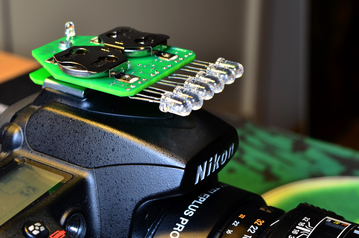

  9. Hi, picking up the threads again after almost two years. I finally got myself the mini flat LED trigger from Hedwig Dieraert in Belgium that fits on the hotshoe of my Nikon D7200 (see pic1, my version has four LEDs). Even better, it also fits in the Ikellte housing that comes with this camera. There is not much space left on top of the housing, just enough. If you wish you can still file off a bit of the two little metal spacers connecting upper and lower green parts of the trigger.

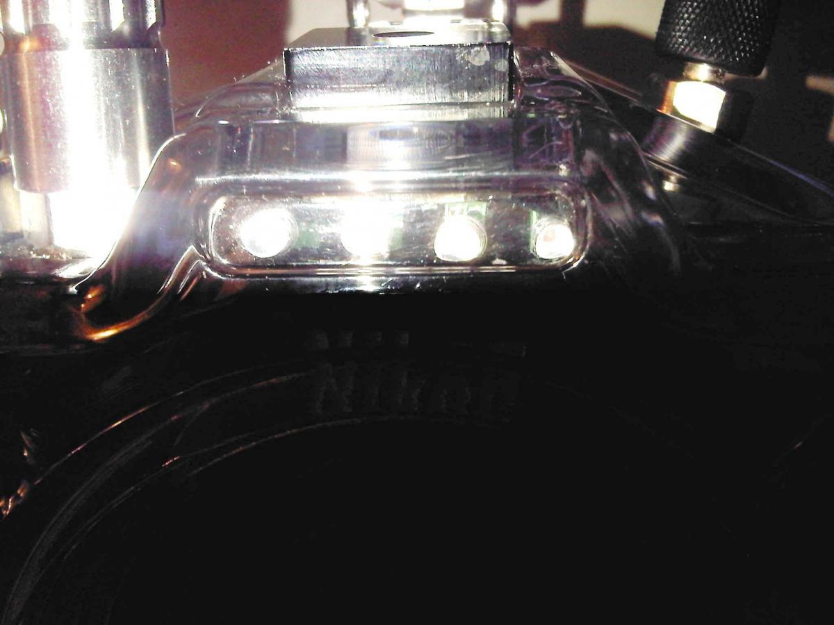

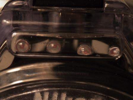

    To make this set up work you need two additional adaptations. First, the Ikelite 4402 strobe mount kit to attach your fiber optical cables to the front of the Ike housing. There is a narrow rectilineair window just behind the Ikelite sticker that you can use to attach the mount kit after removal of the sticker. Be sure that the four LEDs are lined up with, and close to that window (pics 2 and 3). I think that this might work with most strobes that accept optical signals. For the Ikelite DS strobes that are still electrically triggered you will need the new Ike 4401.1 optical adapters that also work with lower intensity LED signals. IF I can get this set up working, I have the nice choice between two options: electrical or optical triggerig. So, if electrical breaks down due to a short or whatever, I can switch to optical (and vice versa) between dives. So you allways have a back up lighting system (-;. I'll keep you informed of future tests in a submersed environment.

  11. Thie is a follow up of my (too) optimistic March 5 posting. Unfortunately I did not succeed in making the mini LED trigger from Hedwig work. The trigger fits op top of the Nikon in the Ikelite DSLR housing, which is nice. But It just wont fire my Ikelite D125 strobes (even equipped with the new optic adapters). I also tried the Inon cables. Same story. Its just the LED ouput that seems to be to weak to trigger the strobes.
    Edited by albert kok

  13. Hi This is meant to announce that as far as I am concerned the problem has been solved. The solution was to use lager diameter optic cables. I use the same Hedwig trigger as described earlier, but now connected it to a LED port attached via a cable to the lower front side of the housing. See http://www.simplesite.com/builder/pages/preview3.aspx?InitPreview=true&pageid=420484432 (16 July Blog).
