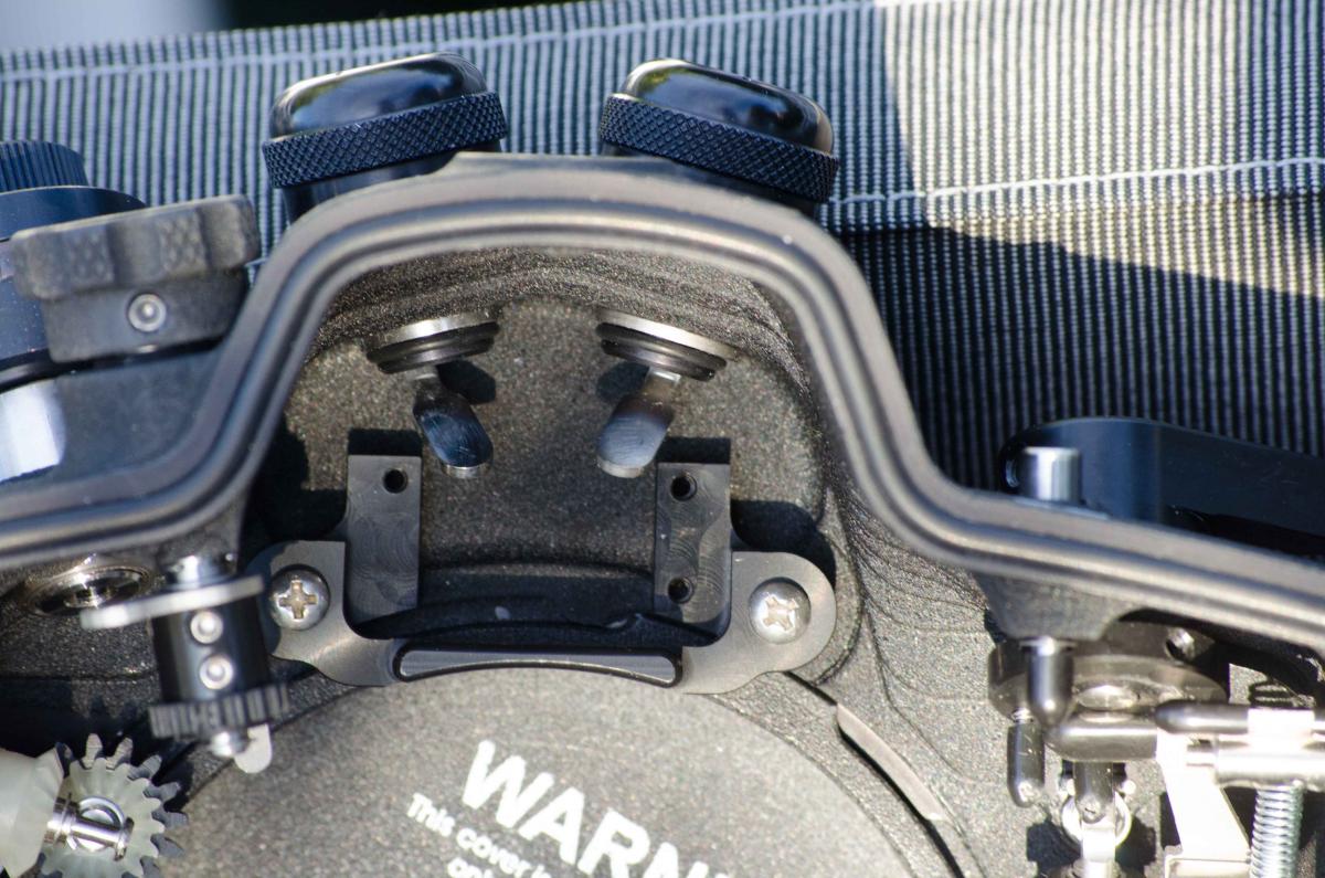

  9. Hi Marjan10000, assuming you haven't got your flash strength set on manual and too low, and your fibre cables are good, then one thing to look at is the little reflector plates inside the housing that direct the light up into the fibre optic ports.
    I bought my AD7000 second hand and when I got it I couldn't get one of my strobes to fire properly. I eventually found that the reflector plate had been knocked and rotated. even a small rotation is enough to reduce the amount of light sent through the cables. I also found it was slightly bent. I carefully realigned it with a pair of pliers and there was a massive increase in the amount of light coming throuigh the cable. I haven't had and issue triggering my strobes since.
    A long shot maybe but worth checking. If you want a photo of what I am talking about let me know and I'll post one.

  11. Hi. Here you go, the two metal strips hang down deflect the light from the flash and up through the port. They can rotate left/right which reduces the amount of light they send up through the port and into the cables. In my case one was bent at a different angle also.
    Bit of a long shot but worth checking.
  12. Thanks Julian. I have the same position, but nop :(
    I tried everything, I tore off part of the cable and replaced with a new one. The camera triggers the flash through a cable, but over the port does not want to. Too small for the amount of light
  13. I had the same problem, but I fixed it by bending the reflector metal strips to a better angle, and now it is flawless.
