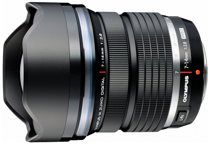

  5. I shoot both lenses the 8mm fisheye with a ZEN 100mm dome and the 7-14 with the ZEN 170mm dome port. The 100mm port is excellent for CFWA shooting as the lens will focus all the way to the glass. Same with Nauticam 4.33 dome. I also shot both Olympus 8 & 7-14 when I used the 4/3 DSLR cameras.
    If you need a wide angle for a trip in one month I would go for the 8mm fisheye for one reason, Olympus will be releasing a new 7-14 F/2.8 M43 lens in the next few months. This lens will be a "PRO" level lens like the stellar 12-40 zoom and will have excellent weather sealing. I would be waiting to see some reviews on the coming lens and go with the 8mm for the time if you intend to get both anyway.

    Image from Olympus press information.
