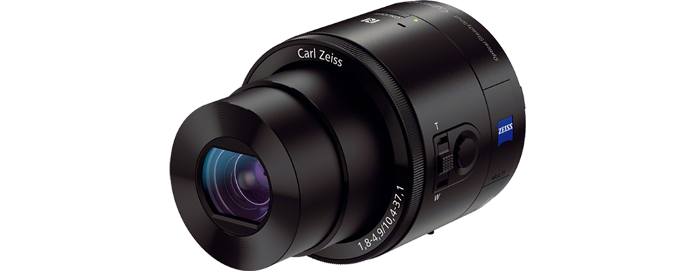

    I've had a chance to play with the Sony QX100 camera lately (gf got it :) ) and i must say it does awesome shots...so instantly an idea popped in my head "why not take it underwater?"
    So ideally a combo: camera in its housing in my hands or attached to something and an other housing with android based smartphone/tablet to serve as monitor and general control panel, perhaps on my arm - as these can connect wirelessly.
    Problem is, while i can get housings for phone/tablet there is no such option for the camera itself..At the moment i am in process of emailing few big names in UW housings to see if they could make a custom one but something tells me it will be either a no or the cost will be ridiculous...
    I am thinking of going one of two ways:
    1) get some video camera/camcoder etc housing that would remotely be the same size ie something like this
    http://www.ebay.co.uk/itm/Panasonic-VW-SPDS9-underwater-housing-/281370710520?pt=UK_AudioTVElectronics_Video_Camcorders&hash=item41830051f8
    And try to adapt it to the camera ie make some internal mounts (not sure what materials to use though)
    it could be the cheapest option but there is a problem with fitting, keeping it stable, lens working correctly and of course no buttons at all - so camera would have to be switched on before putting it in the housing and then left on for the whole dive
    2) order custom made housing...as mentioned before, emailed a few big names, so far had only one reply and its a no...wondering if anybody can recommend some smaller companies/private people that would be able to do something like this ? Ideally UK/Europe based but could work worldwide...
    It would be a "minimal" housing...just on/off button, shutter (just in case) and perhaps zoom control (though could skip this one in favour of controlling it from the tablet, if its too complicated/expensive)
    So thought will ask here...can anybody recommend anything? Any experience in making the camera fit other housing? Any other ideas? Would be grateful for any advice :)
    Also, i wonder, how WIFI would perform underwater....anybody tried this?
    Link to the camera:
    http://www.sony.co.uk/electronics/cyber-shot-compact-cameras/dsc-qx100
    Marcin
