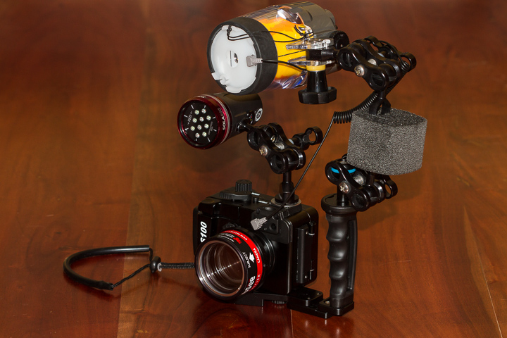

  3. Hi Tom,
    I'm thinking it may depend on the ergonomics of your specific housing and handles. On my S100 setup I like using just one handle on the left because of the way my right hand fits on the housing and the shutter release. When using two strobes I mount the second on the ball attached to the top of the housing where the focus light is in this image.. I've also seen folks use a Y clamp off one ball to mount two strobes on a small hosing. But as noted I'm not using it for video.
    Good luck,
    Steve
  4. Steve set up is quite neat for macro and close up work for both stills and video. For wide angle you want to be able to widen the light beams so for me a second arm mounting point is essential and as usually my arms are quite heavy on land I would not chance the cold shoe or the M10 ball mount point
