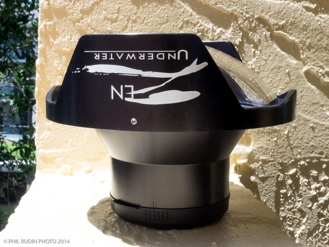

  8. The newest Zen Underwater port, the DP 170 n85II has the extra extension built-in (30mm) and works like a charm. It will work well with Panasonic 7-14 and 12-35mm zooms, also Olympus 12-40mm, 9-18mm and Sony 10-18mm. Olympus has announced its own "Pro" 7-14mm F/2.8 zoom with the weather sealing and much more coming in the first qtr. 2015, It appears that this lens may also work in the port.
    Attached is the new port.
