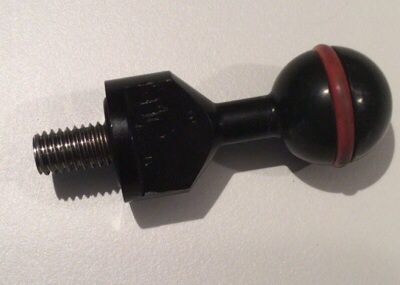

  1. Hi,
    The adapter on the attached pic is for using an Ikelite strobe with ULCS and similar strobe arms. I want to use it in a DIY project and need a screw nut for it.
    All I know is that the thread is definitively not metric... Could someone please help and provide the specifications (like UNC 1/2")? Thanks!
    Jock

  2. My guess is 1/4-20 but I don't know what strobe this is for.
    Bill

    thanks for your answer - it is for a SS200 strobe (the old workhorse...)
    Jock
    Edit:
    Just measured - the outer diameter is 9.5mm, which is 0.374", so 1/4" will be too small.
    Edited by Jock
  4. In that case it is a 3/8 16 the threads look to be too far apart to be the 3/8-24.
  5. 3/8 is also the larger sized standard tripod screw size - you might have a tripod head or camera with a female thread to test it on. Since you are in Germany, going to a hardware store to match may not be an option like it is in the US (which is what I have done with underwater gizmos for DIY projects) but maybe try automobile parts stores catering to US cars (if such exists).
  6. @ Bill and Tom,
    thanks! There are a few specialized hardware stores around Cologne, but instead of trying to find it there (stainless doesn't make it easier), I searched on ebay Germany and found it.

  9. Feedback - just in case anyone else is searching for this information: Bill was right, the thread is 3/8-16.
    Thanks again,
