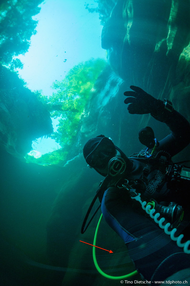

  1. Hi,
    I use the Sony E 16mm F2.8, with the ECF1 Fisheye currently on my Sony NEX-5N Setup in Nauticam housing and the 4.33" Dome Port. I would love to know whether the Sony SEL 10-18mm F4 OSS E with the 7" Dome Port has also problems with these reflections?

  3. Almost every camera + housing might have these reflections. It's because the port glass / acrylic is a reflective surface and the camera / lens tend to have reflective rings on them.
    If the rings on the lens catch light, you will get those reflections.
    It can happen from the pop-up flash or from strong ambient light such as the photo you posted. (assuming it was taken without flash).
    The best way to get rid of them, is actually to slightly "violate" your lens and paint over the reflective rings with a black marker. Do it carefully of course as to not harm your actual glass. You can also cut out black stickers to fit precisely if you don't want to stain your lens permanently.
