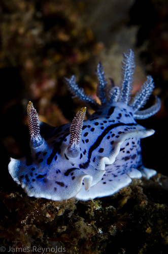

  2. Nikon glass, 60 vs 105, both at F22 - Seems like the 105 definitely has a shallower DOF... these were taken on a DX (crop) sensor body.
    60mm
    105mm
    HTH

  7. Yes, they were shot from different distance as mentioned above. We know this to be true due to the different focal lengths of the lenses used to get the desired magnification/composition/etc for the shot.
    That said, the shot from the 105 is not cropped at all, while the shot from the 60 was cropped -- it was shot in landscape, and I cropped the image to portrait, leaving the nudibranch the same size as shot in the original raw file. I basically just cut off the sides.
