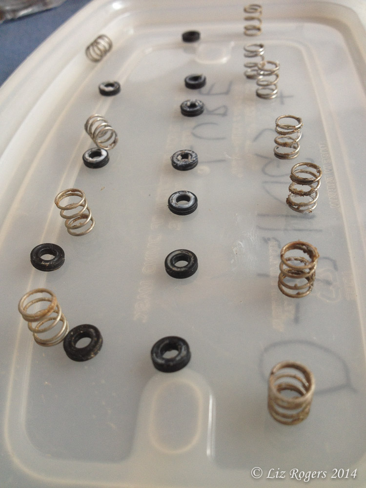

  1. With 30 knot winds around here this weekend, I had a productive few hours installing the deep spring kit on my Aquatica housing instead. I'm off to do my MOD3 course on my rEvo at Christmas, so the housing will definitely be going past 60m. Given my caving and cave diving activities I expected a bit of dirt in the buttons as I removed them. What I found was a lot of dirt! I was surprised and impressed to see the amount of grit built up in the spring and how well it was all staying on the outside of the two year old o-rings. I haven't had any button leaks to date.
    Hopefully the replacement springs and o-rings are going to stay just as dry as the old ones. And hopefully they're going to work well down in the depths....any advice or experiences appreciated.
