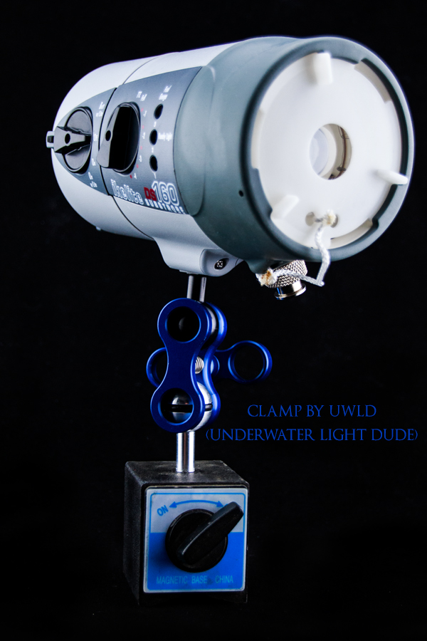

  5. To follow up on the mounting issue... A good buddy came up with a magnetic mount that will work great and keep it tucked in-between the tanks. Granted, it only works on steel tanks but that is not an issue with the group. This approach will not only keep a very low profile but also allow easy removal. I thought it was a clever approach that I hadn't considered...and thus thought I would share here.
    Don

  9. Here is a very quick pic showing what we came up with. This is shown here fully extended; however, when positioned on doubles, the profile is very minimal when folded down. A buddy machined the ball mount and since I was doing a shoot for some cool UWLD products, thought I would use their clamp in the photo instead of the ones I normally use.
    Don
    Edited by decostanza
