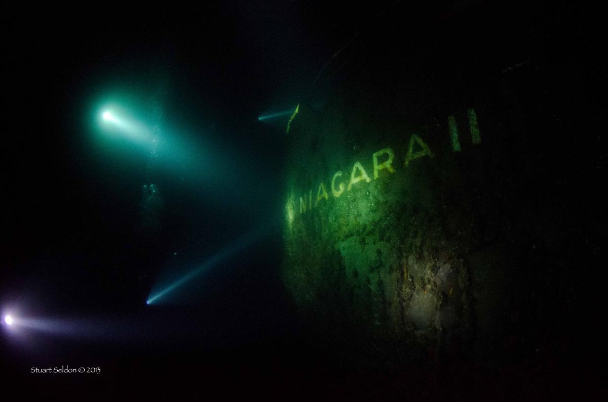

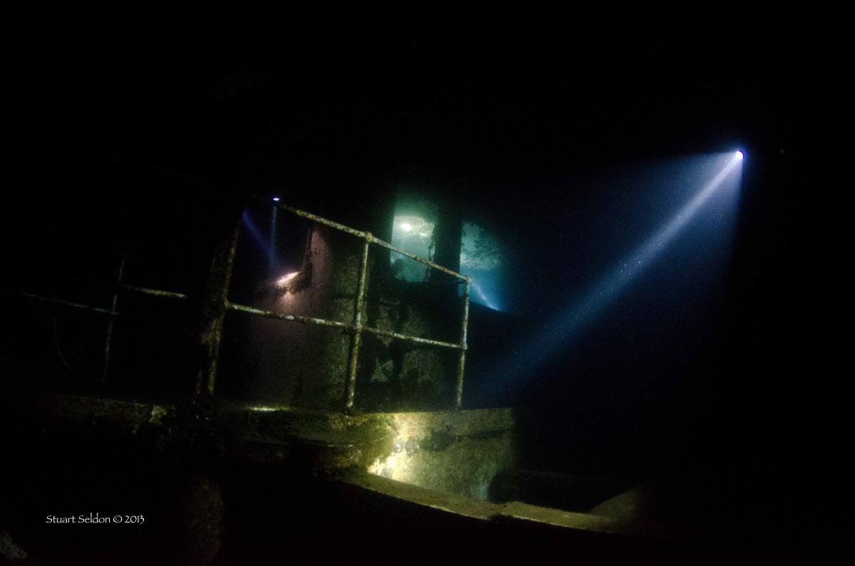

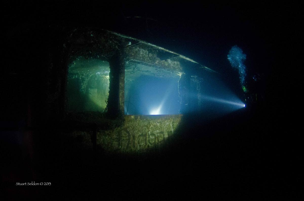

  5. Here are some examples on other subjects:

  7.
    Thanks.. what kinda exposure time on these ones Akex ?

  10. These aren't anything special... I took them by way of "research" for a more grand plan, which has yet to come into place...
    I bumped my ISO up to 6400 or something, then shot at 1/30, f 3.5 or close to it. Almost no post processing... and no strobes at all of course.
  11. These aren't anything special... I took them by way of "research" for a more grand plan, which has yet to come into place...
    Not really long exposure tho, as you can do this without a tripod (or simular)
  12. Not really long exposure tho, as you can do this without a tripod (or simular)
    Nope... That's where the high ISO comes in. These new-fangled cameras are awfully good with "noise"
    I am going to try to light up the entire bow of an old schooner in Tobermory one of these days. The challenge is coordinating a half-dozen competent divers in 110' of water at night. With my friends, any dive scheduled after happy-hour is likely to be cancelled. I might need to bribe them! ;-)
