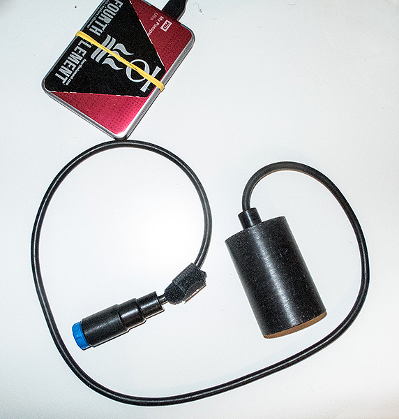

  3. I strongly agree that slave sensors need a length of straight cable. Although it doesn't need to be as long as you might think. I find about 50cm is fine. Longer gets caught of everything - and you never want your off-camera strobes that far away or that hidden - otherwise they have only a tiny impact in a fisheye shot.
    When I designed my slave triggers (which predate the Triggerfish) I included a length of straight cable for this reason (hard drive for scale):
    I also helped in the development of the Triggerfish, testing the first prototype and commented to Hedwig that he should include a length of strait cable in the design, but this would have greatly increased the cost - which is true. Pete Ladell manufacturers the slave sensors I designed and finds most people aren't interested when they ask about the cost. I also use the Triggerfish, which are great because of their small size, although limiting for certain shots.
