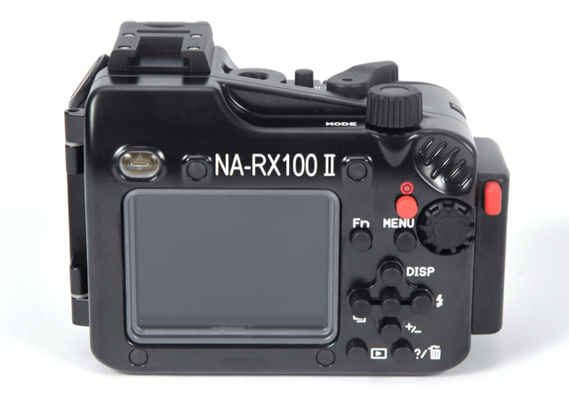

  5. I have a Nauticam Rx100ii here in front of me now and I cannot find a control that I don\t have access to from outside the housing.

  7. I have a Nauticam Rx100ii here in front of me now and I cannot find a control that I don\t have access to from outside the housing.
    Really?? I briefly touch one and I can't adjust all the three setting at the same time in manual mode. I hope u can share this !!
    I can only set 2, usually I put shutter speed and aperture. Aperture by pressing the down button. Then adjust. Shutter speed adjust using the front dial. For ISO. I can set it to be any other button to activate it... But I can't adjust it.
    Good to learn this!!
  8. Your camera settings are wrong. The sony has a trinav button. You can use front ring for aperture back for shutter speed for ISO you either have to set a shortcut on the back or use the function button. Nothing to do with the housing as it controls all of those
  9. The function button. U can only set the ISO. Choose it.. Then u can use the front dial to toggle it. That done for ISO.
    Aperture... Set it to the front dial. Turning it.. The aperture is toggling.
    Now for shutter speed.
    In manual mode. U press the down button.. Then u can switch between shutter speed or aperture. When I choose shutter speed... Pressing the left or right button, up or down button dun toggle shutter speed. Turning the front dial with the shutter speed selected... The aperture start moving...
    I missing something here???

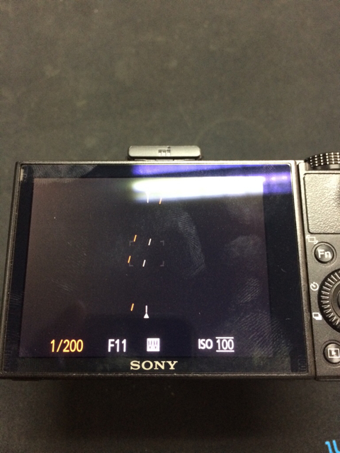

    Here are my settings
    Edited by hellhole
    This is how my manual screen looks like
    The red/orange on the shutter speed. Means it is selected. I can use the back jog dial to change it... But the housing only have button at the back. Then if u job dial from the front dial... It pops into aperture changing
  11. Yes the back wheel can be rotated to change the shutter speed it is called tri nav as you can press the side rotate and press the center
  12. Yes the back wheel can be rotated to change the shutter speed it is called tri nav as you can press the side rotate and press the center
    Okay. Let me see if I underatand...
    So ... On the back buttons... I press the left or right button and the centre button together... ?? That will move the shutter speed?
    I need to take a picture of my menu....
  13. You need to rotate the wheel [emoji21]
  14. You need to rotate the wheel [emoji21]
    Okay. I press down button to select the shutter speed. Then I turn the front dial.. To choose the shutter speed I want... ?
    That dun work.. As the front dial is set to aperture .... U turn that it starts moving the aperture instead.
  15. Nope you rotate the rear dial
  16. Nope you rotate the rear dial
    Where is the rear dial on the Nauticam housing??
    Sorry if everything is mislead by the topic title. I am looking to see how u can adjust all the 3 setting on a non rear dial housing.
    Edited by hellhole
  17. What does that wheel close to the menu button looks like to you?
  18. What does that wheel close to the menu button looks like to you?
    Dammit!! I must be blind ....!!! Sorry man! Now I get it!!! Thanks...
    I need to get that Nauticam housing back in to take a look!!! Thanks!!

    i would like to say.. i am wrong.. the nauticam does have a control ring at the back.. therefore.. it is able to have full control ont he RX100
