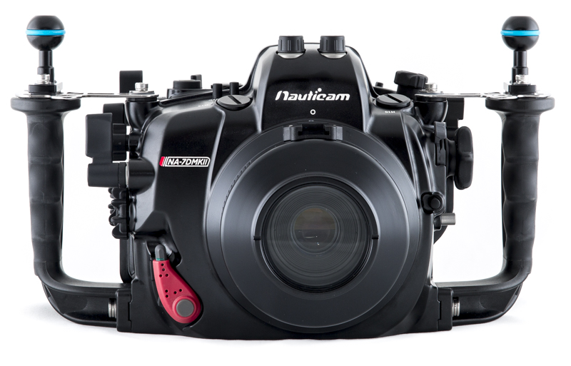

    General Impressions
    The design, quality of manufacture and the finish of the NA-7DMKII is excellent.
    A lot of thought has been put into minimising the weight of the housing, for example:
    • Where the stainless braces from the housing to the top of the handles on earlier housings is a solid piece of metal, the same fitting on the NA-7DMKII has cut outs to reduce weight
    • The port locking lever on the front of the housing is now made of plastic instead of metal as used on earlier housings; and
    • Hollow control rods inside the housing have been drilled to remove metal to reduce weight.

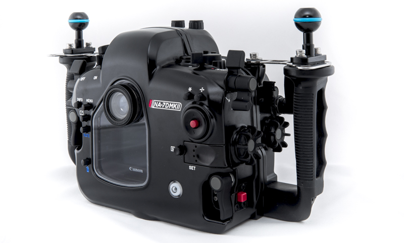

    The ergonomics of the housing and location of controls is excellent:
    • Nearly all controls on the housing have been located so they can be easily operated without having to remove your hands from the handles
    • The only two exceptions to this are the White Balance/Metering Pattern and AF Drive buttons. This is not a problem for me as I have rarely if ever used these buttons on the original NA-7D and the new NA-7DMKII housings. These functions are much more easily done without having to remove your hands from the handles by using the “Q” (Quick Control) button and Multicontroller.
    • I’m more than happy to say goodbye to the three fiddly suitcase type latches on the original NA-7D housing (I believe this was the last Nauticam housing to use them). The new NA-7DMKII uses two very easily operated latches similar to what is used on Subal housings, I like them a lot.

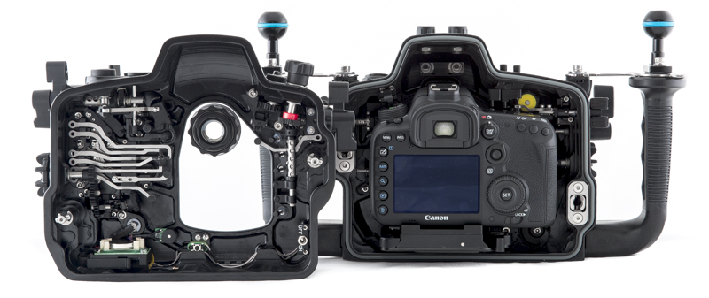

    Internal Flash Controls
    I’m very happy to see a full set of controls on the NA-7DMKII housing to raise, lower and control the 7D-MkII’s internal flash. No more:
    • Cursing after putting my rig together and realising that I didn’t raise the camera’s internal flash having to put the camera into Auto mode to raise the flash and then returning it to manual mode.
    • Having to dive deep into the camera’s menu to disable the flash so I can shoot at faster shutter speeds faster than 1/250 for ambient light only shots and then having to go back into the menu when I want to enable the internal flash again.
    The NA-7DMKII has one button on the left side of the housing to raise the flash. Once the flash is raised, another press of this button takes you straight into the flash control menu so you can easily change the flash from manual to ETTL, change from first to second curtain sync, change manual flash power, etc, etc. There is a second control on the top of the housing next to the on/off switch which lowers the flash and disables it to enable shooting at shutter speeds faster than 1/250.
    Image Review Controls
    As previously mentioned the image review controls on the 7D MkII have changed a lot from earlier Canon DX dSLRs. The controls on the NA-7DMKII housing to perform image review are excellent and made it very easy to adjust to the new (to me) method of image review, these controls are:
    • A double side lever control at the top left hand side of the housing. Pushing the lower side of the lever enables/disables image review. Pushing the top half of the lever enables zooming/panning of the image and zooms in by about 100%. If already zoomed in returns the image to non-zoomed in size
    • Once zooming in is enabled the amount of zoom is controlled using the Main (front) dial and panning around the zoomed in image is controlled using the Multicontroller which is located top right of the housing back directly under your thumb
    Controls on Right Hand Side of Housing
    The controls on the right side of the housing are:
    • Shutter Release – Although the shutter release on the original NA-7D housing was very good the same control on the NA-7DMKII is much better. Instead of being a direct lever onto the camera’s shutter button it is now put through a series of gears which reduces the travel of the internal lever contacting the camera’s shutter button in relation to the exterior lever. As a result the shutter release has much more feel and it is much easier to hold a half press when focussing and recomposing.
    • Main (front) and Quick Control (rear) Dials – These are a huge improvement over those fitted to the original NA-7D housing. Located flat against the housing side and with a highly textured surface they are very easy and smooth to operate (even with gloves)
    • ISO and M-Fn Lever – Although located on the top of the camera these controls have been combined into one double ended control lever on the right hand side of the housing just behind the shutter release. These controls are very easy to use, push on the lower half of the lever with your thumb and the ISO/Flash Exposure Compensation menu is activated. ISO is adjusted using the Main (front) dial and Flash Exposure Compensation using the Quick Control (rear) dial. . When changing AF point selection options, after pressing the AF Point Selection button on the back of the housing pressing on the upper half of the lever with your thumb cycles through the available options. When finished with either control press the Set button and it’s done. Couldn’t be easier and all without taking your hands off the handles
    • AF-On and Start/Stop – Located on the same spindle with AF-On to the left away from the housing and Start/Stop closest to the housing. Both controls are directly under your thumb and very easy to access and use

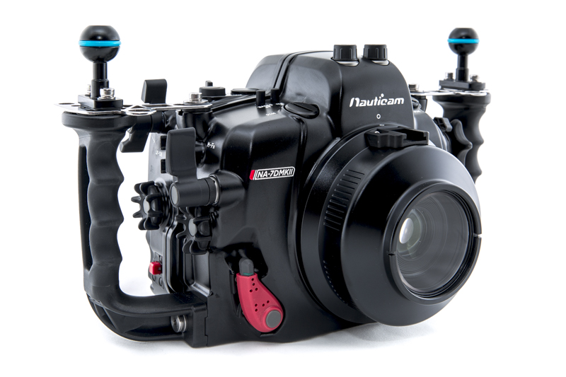

    Controls on Left Hand Side of Housing
    Apart from the previously mentioned Image Review Lever and Raise Flash button the other controls on the left hand side of the housing are:
    • Lens Release Button – Located centrally towards the front of the housing and allows changing lenses through the front port
    • Zoom/Manual Focus Control – A large control with large lobes and a rubberised finished that is very easy to turn. It has a lever that moves it in and out of contact with the gear on the lens in use. This has a couple of benefits compared to the original NA-7D housing. Loading the camera with a lens fitted with a zoom/focus gear is much easier. With the gear on the control moved out of contact range it very easy to push the camera into position in the housing. On my old NA-7D housing this wasn’t possible as the gear was fixed and you had to jiggle the zoom/focus control to get the gears on the housing and lens to mesh properly as you pushed the camera in. The other big improvement with this arrangement is that the gear on this control is now spring loaded and when engaged with the gear on the lens imparts some sideways force onto the zoom/focus gear on the lens. This appears to improve the grip between the zoom/focus gear and the lens and feel of zooming or manually focussing is very much more positive in the NA-7DMKII than with the same lens and gear in the original NA-7D.
    Controls on Top of Housing
    Apart from the previously discussed White Balance/Metering Pattern and AF Drive buttons the other controls on top of the housing are:
    • Movie/Live View Control – Located on the right hand side and easily accessed and operated using your right hand thumb without having to remove your hands from the handles
    • On/Off Switch – Located on the left hand side and easily accessed and operated using your left hand thumb without having to remove your hands from the handles
    • Mode Control Dial – Located on the left hand side and can be accessed and operated using your left hand thumb and forefinger without having to remove your hands from the handles. In their wisdom Canon decided to add a button to this control on the 7D MkII that has to be pushed in to turn it. Nauticam have added a spring loaded lever inside the NA-7DMKII housing that automatically keeps the button depressed at all times. When putting the camera into the housing sometimes this lever can also turn the dial as it engages with the button and the mode is changed from what was set, it is prudent to check what mode the camera is set to after assembling your rig. I don’t see this as a fault with the NA-7DMKII housing, if Canon hadn’t added the button to the dial (it was not on any of my previous Canon dSLRs) it wouldn’t be a problem.
