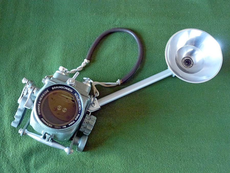

  1. I just bought in a Rolleimarin housing complete with flash and canvas bags and all in very clean condition other than I can't get it apart as yet - I don't think that its been opened in a very long time. But how do I figure out which version I've got (I to IV I believe) and which version of the camera (3.5F) to look for to put inside. I'm not sure what I'll actually do with it - its very clean as I said and perhaps a little long in the tooth for actual use - but its a fabulous looking beast and will make a great display item if nothing else.

  3. Hi Steve
    Here's a very quick 'snap' - nowhere to take pix here at the moment as we have builders in!

  4. Paul,
    Have you opened it yet? If not undo clamp with front port on the edge of a bench(Some place sturdy) and swing clamp over the housing and rest where it stops and give a few raps, if that doesn't work leave the housing unlatched in a safe location for a day and repeat. google Rollimarin instructions online for future use. www.cameramanuals.com or http://www.butkus.org

  5. If the serial number of the housing is 1400 (on the front ring; can't read it in the pic you posted) or greater it is a Rolleimarin IV and will fit 3.5F models with serial number 2,250,000 and above. A 3.5E with a high SN as well - as this is what I have - the 3.5E's do not have the knob light meter of the 3.5F's. Earlier models will fit other f/3.5 Rollei models (note lower case f), including some models with Tessar/Xenar lenses as opposed to the Planar/Xenotar lenses. The different lenses require different interface units - the gizmo that fits over the front of the camera - since the filter sizes are different (used to mount the gizmo).
