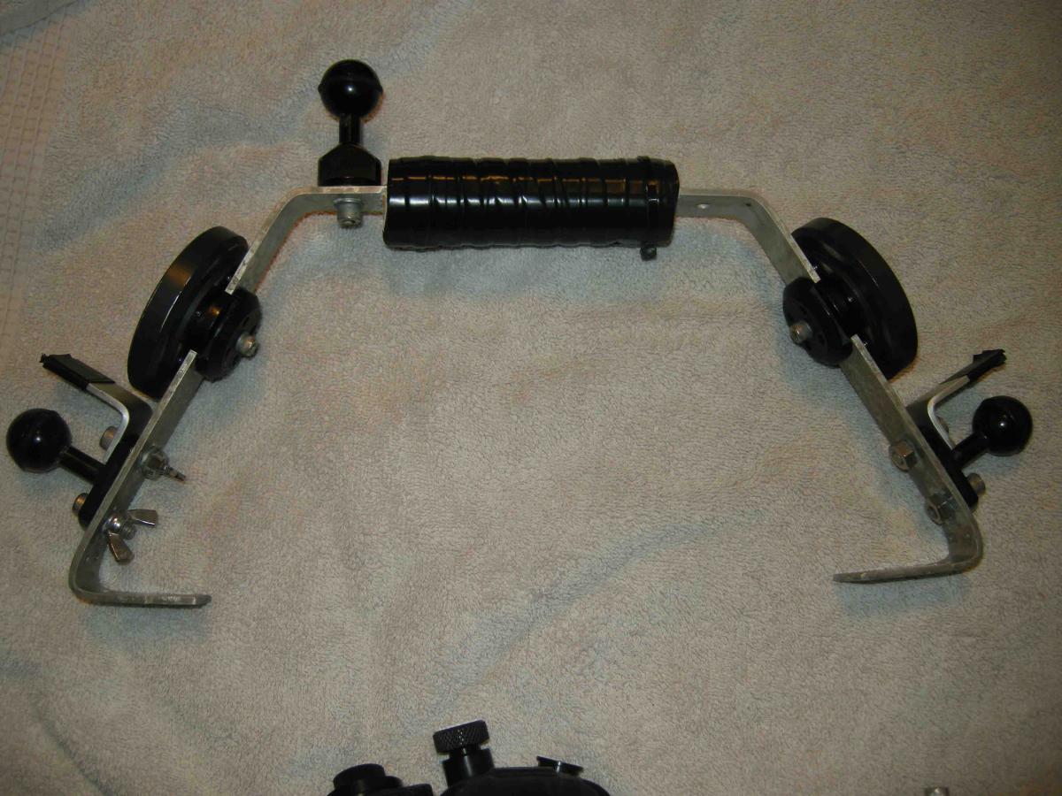

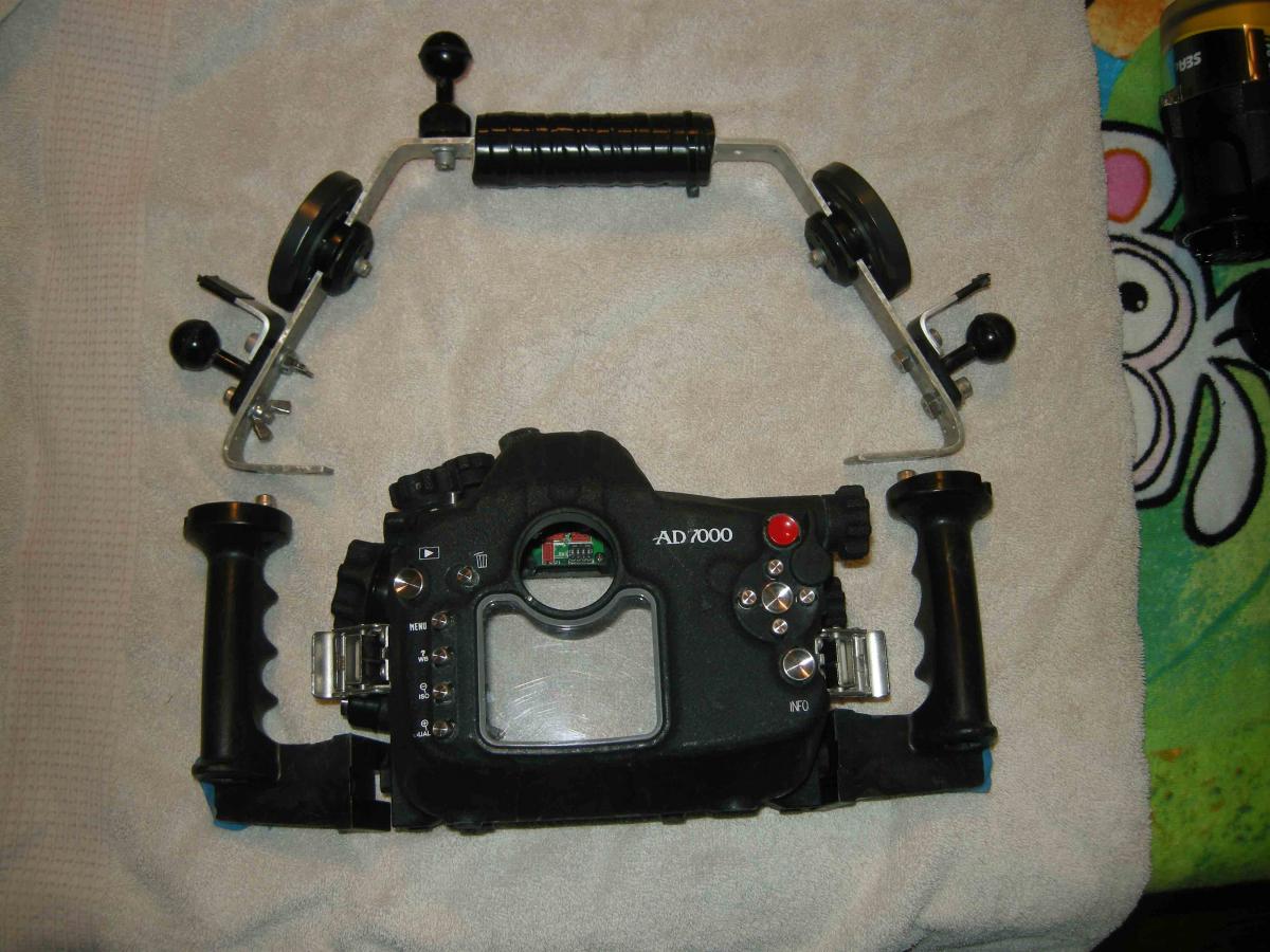

  7. jimj,
    Here's another idea to solve the problem. I made this bar out of 1/8" x 1" aluminum stock. All it took was a vice, hammer and a drill. I used all SS machine and cap screws . It can be adapted for a number of accessories. I attach the focus light to the top ball and diopters to the sides above the balls for the strobe arms. On occasion I also attach a Go-Pro to the right of the lifting handle. It also serves as a lift point when handling the kit, making it easy to hand down and up. Nobody grabs the strobe arms or worse.
    The pics show it all disassembled as everything is in storage, but you get the idea. PM me if you want any further details.
    Harry
  8. The biggest advantage to my DIY solution, IMO, is the ease with which one can handle the camera on a dive boat. The grab point on the top of the bar is easy for the crew to hold when passing the rig up and down from the boat or dive platform. No grabbing of the strobe arms or housing/handles.
    Plus it's a fraction of the cost of the cost of a retail unit. It cost me about $5 USD and most of that was for the SS bolts and machine screws.
    Just my 2 psi.

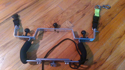

  10. I did the same
