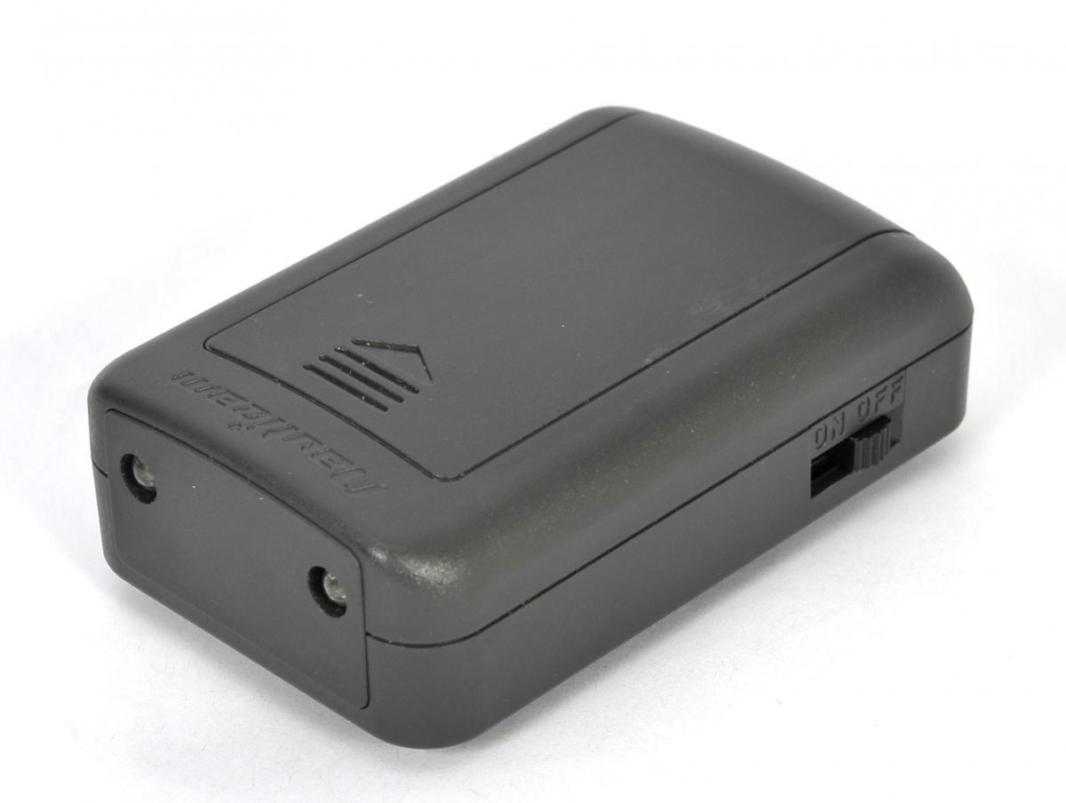

  2. This is a question I would be interested in finding out as well.
    I would very much like to see Nauticam make a flash trigger for the OM-D cameras like they make for Canon, Nikon, Sony (A7 line) and in a mini version for Panasonic GH-4 and Fujifilm XT1. The flash trigger is designed for use with fiber optic cables only and work in TTL for some camera brands and in manual flash power settings for other brands like Panasonic.
    I use manual flash settings exclusively and I am sure many other OM-D users do the same based on the numbers of comments on this and other forms regarding the use of the OM-D's 1/64th power setting to conserve the camera's battery power. The Nauticam flash triggers are powered by a small flat user replaceable battery which lasts for quite some time because of the very low power draw required to trigger the small LCD lights. With external strobes like the Inon Z-240's set to low power settings you have the ability to shoot at several frames a second with proper strobe batteries. These flash triggers are very useful tools and conserve the cameras battery power which is one of the down sides to the Olympus OM-D line of cameras.
    All of the Nauticam flash triggers retail for $220.00 in the US. The price would be worth it to me for the additional creative ability of shooting at 6 to 10 frames per second and for the ability to squeeze several more shots out of the Olympus camera battery.
    Did not mean to side track your thread oskar but would be interested to know if any other OM-D users would be buyers for a Nauticam flash trigger.

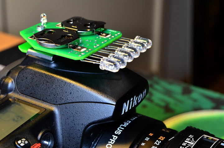

  5. I have successfully removed the plastic gizmo and successfully used the Hedwig LED solution. Works great.
    Bill
  6. I have successfully removed the plastic gizmo and successfully used the Hedwig LED solution. Works great.
    Bill
    Great, only those two hex screws and it came of easily without too much violence?

  7. The Nauticam flash trigger is an add-on for quite a few camera makers and started off being made for high-end cameras like Canon EOS 1D and Nikon D4 that don't come with pop-up flashes. It allowed those cameras to be used with fiber optics when in the past bulkhead wiring was the only real choice.
    While I have no issue with the Hedwig system which I have never used I think you will see the clear difference between the two and it would be nice to have the choice at both price points of around $90.00US and $220.00US.

  11. I just add that the plastic flash thingy comes off easily with the two hex screws using the housing toolkit. I used two red laser modules for the flash. The good thing is there's plenty of intensity, the drawback is that the alignment is critical so I had to align really carefully before gluing them in position.
    Cheers/O

  12. I just add that the plastic flash thingy comes off easily with the two hex screws using the housing toolkit. I used two red laser modules for the flash. The good thing is there's plenty of intensity, the drawback is that the alignment is critical so I had to align really carefully before gluing them in position.
    Cheers/O
    Cuold you put an image of your DIY flash? Sounds good...
