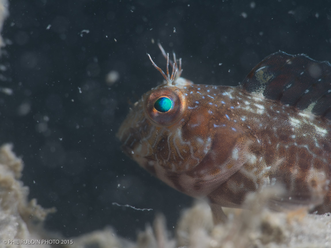

  4. Many would agree that the Nauticam SMC is the sharpest water contact C/U lens to date and works over a wide range of sensor sizes. The Nauticam CMC-1 is designed for a verity of contact and mirrorless sub full frame sensors and it could also be argued that on those cameras it is even sharper than SMC by a bit. It gets some of the best magnification with the Olympus 60mm macro lens for M43 cameras. I was able to barrow the lens for one dive in two foot vis with horrible conditions. The attached photo was taken with the Olympus 60mm macro at 1:1 (life-size 17.3 X 13mm) with the CMC-1 installed the image is around 9mm on the long side. This is an unprocessed RAW file. The second image is a crop of about 400% with some PP.

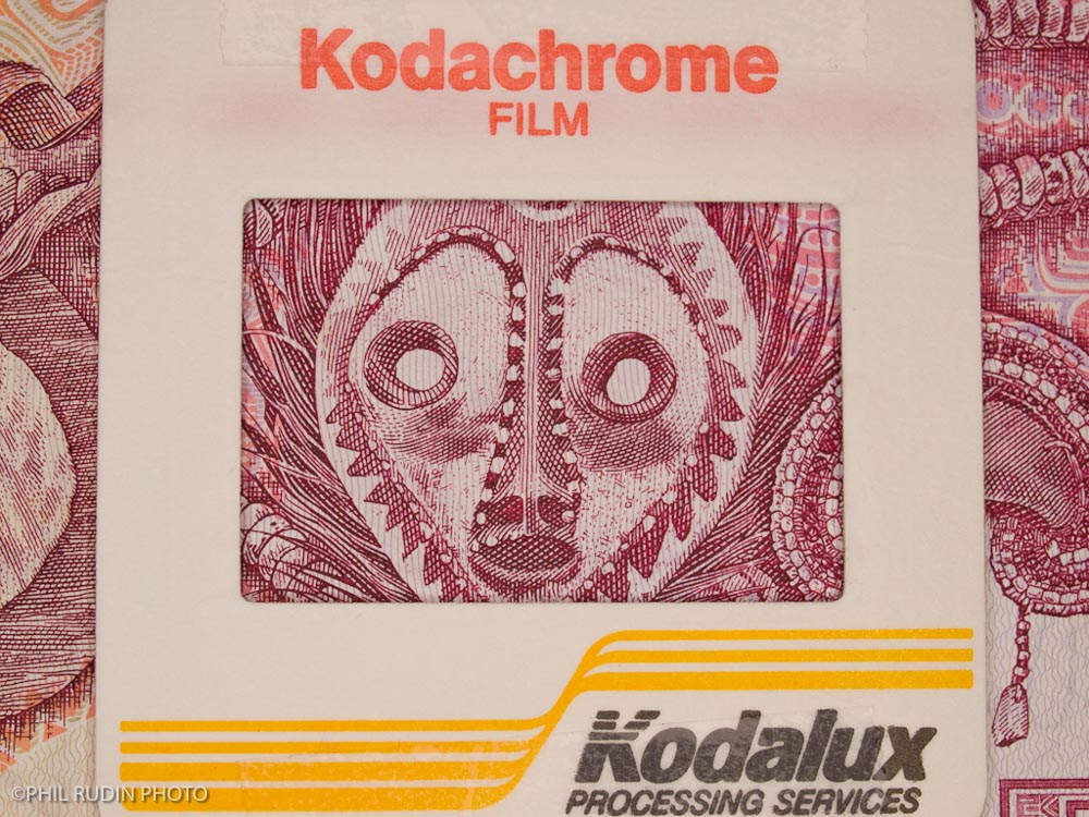

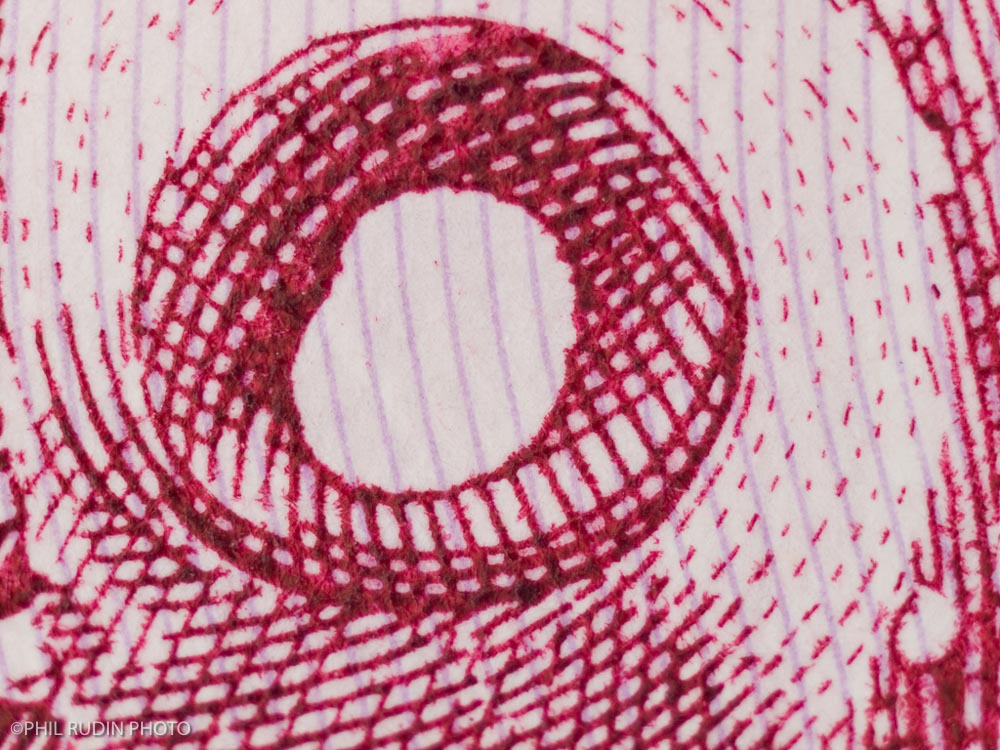

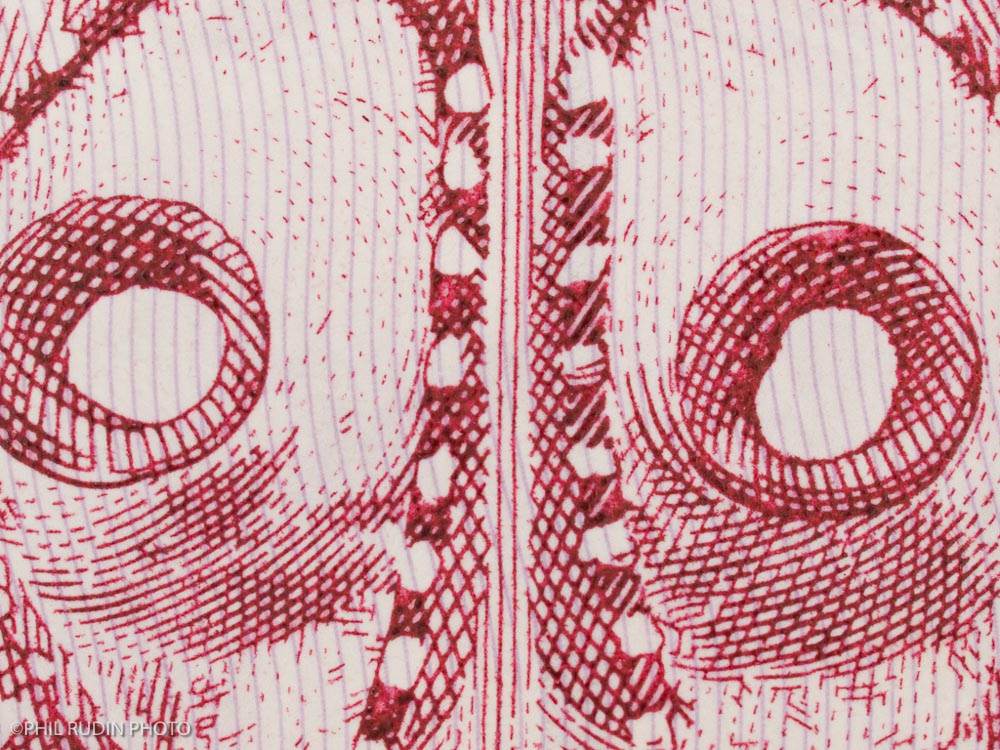

    The problem with the C/U lenses is that many people use the lens before they have reached 1:1 with the 60 and other macro lenses. As a result I see images of animals much larger than the 17.2mm X 13mm life size of the m43 60 macro lens. So as Bill has said in the hands of someone who knows how to use the C/U lens you can get excellent magnification but many are using like a placebo only think they are getting higher magnification.
    These are images I have posted here several times, the configuration is EM-1 60mm macro manual focus to 1:1 (life size) then move the housing until in focus. First is the 35mm slide as a frame of reference, the 60mm life size and then 60mm at life size plus CMC. As you can see a very small final image taken a less than 10mm and very shallow DOF. Most people are not getting this close even when they use a C/U lens.
    So you can see full frame life size and the final eye image and make your own evaluation of how close that comes to 7:1 magnification.

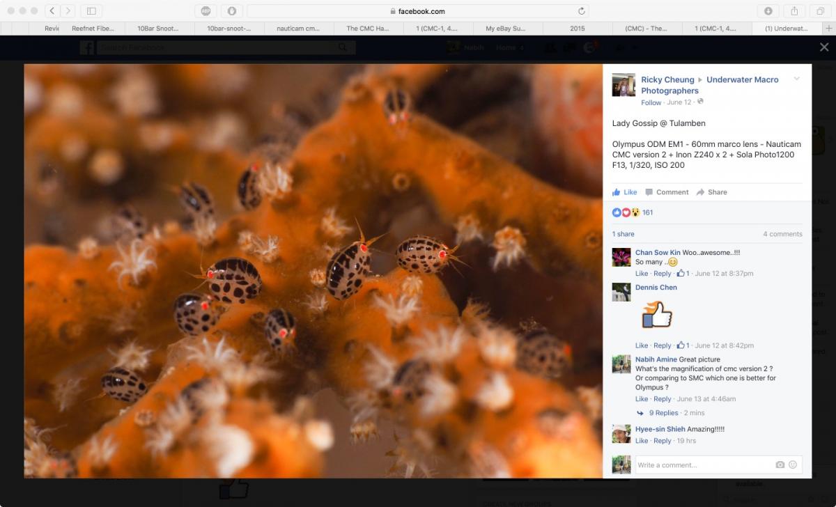

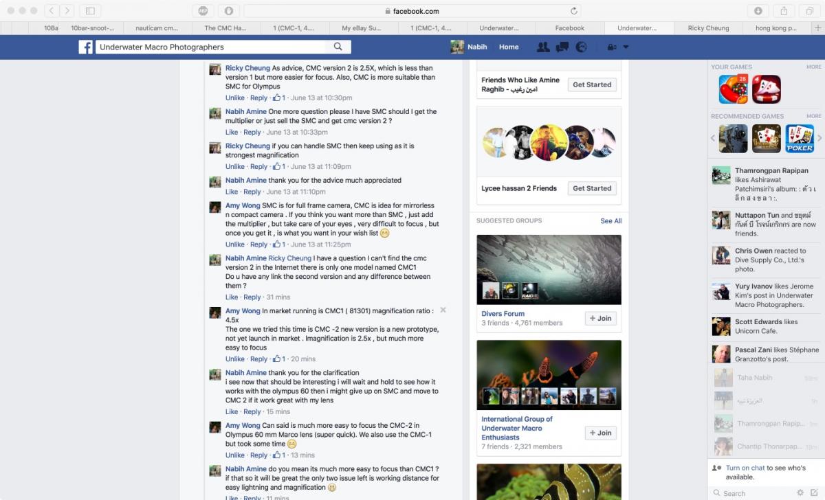

    about the confusion that i had between cmc and cmc1 i just clear it , there is a new CMC 2 coming to the market now they start trying it. its sharper focus very fast they said its much better than CMC 1 . but less magnification . the old CMC give 2/1 the new CMC 2 would have 2.5 magnification i don't know whats gonna be the ration in olympus lens .
    according to what i understand from you i will use the SMC for now until the new CMC 2 comes to the market i will compare it to the old CMC 1 then i will sell the SMC to somebody who will use it in full frame , i will make my choice between CMC 1 or CMC 2 the old model have more magnification the new model less magnification but sharper and focus very fast . i will attach some pictures to show the conversation with some ppl who try the prototype of the new CMC 2
