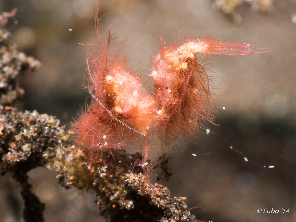

  3. I am using it behind Nauticam dome for Oly 9-18mm and it works very well. So well I am not sure if it is worth the hassle of having to change ports when I switch to this lens. Only minor issue is port size - getting it close to reef without scratching it - and possibility of better magnification with flat port.
    This chicken hairy shrimp was tiny bit bigger than tip of diveguide stick, it is cropped heavily but the detail level is still amazing.
  4. Frankly I have the 60mm macro lens and used it behind the flat port... afterward I used it behind the 4" Nauticam port and found that I get 30% better FOV and get the same magnification by getting closer to the subject.
    As I have the flip macro adapter for this port (I use it especially when I use the 12-50mm lens) I get supermacro details by using it with the 60mm macro lens.
    No quality issues that I can tell.
    BTW the 9-18mm minimum focus distance is 20mm so it is clearly no problem with the focusing on the 60mm lens.
    It is bigger than the flat port ... but that is the only negative i have to deal with vs. the flat port...
