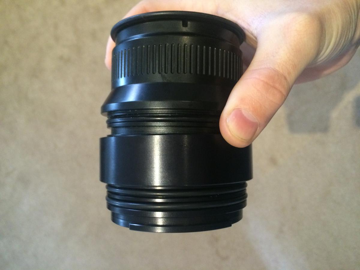

  2. Hi. The only option I am aware of is the Zen flat port for the pannasonic 45mm macro and the Zen 25mm extension. I bought the zen flat port and then decided I wanted the Oly 60mm. Just haven't for round to buying the lens yet. Haha
    I contacted Alex at UW vision and he was very helpful. I'm ordering and dispatching the extension.

  3. Here are the two ports. Zen flat port also had a 67mm thread. Which will allow a wet lens.

  5. The ZEN port plus extension
    Not ectastic about the extra joint and O rings but I suppose it should not be an issue as I would not have to disturb it. The port is £325 plus the extension ??
