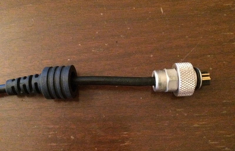

  7. A few years ago i used Ikelite Strobes and cords. They had an inherent defect and sooner than later the cords at the ends would have issues affecting firing of strobes. After a while they started supplying cords with rubber protectors at the ends. This did help but the problem would sometimes recur. I finally started using this at the ends of the cords and post that had no issues at all.

  8. Thanks - so you pulled back the strain relief rubber protector and taped on the wire up to the fitting (see pic)? I may do this as well on my new cord. This cord that failed is about 14 months old, and although it has seen a lot of use, it is an expensive cord to be tossing in the garbage. Maybe my expectations on how long stuff should last are too high. :huh:

    Yes that's how i did it. Never had issues after ...
