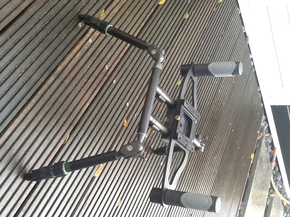

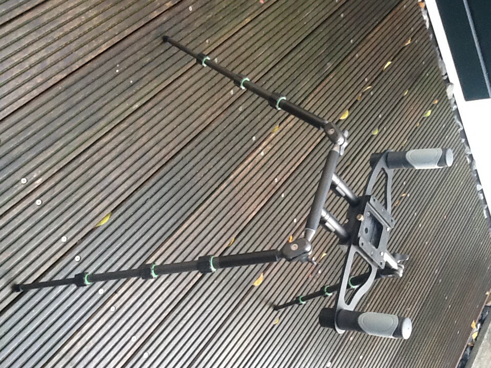

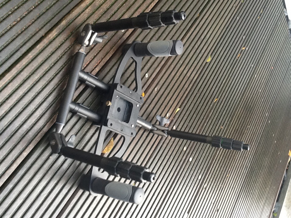

  3. If you are a bit handy, this is what I have made myself. The bracket with the handles on it is part of my Gates video housing. The rest is DIY. A old tripod an some spare time.
    Kudos for the DIY tripod! Wow! You can also adjust the leg's length! But bit cumbersome to extend them underwater considering the leg section is not that long don't you think? But it sure looks good!
