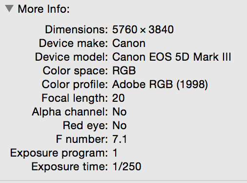

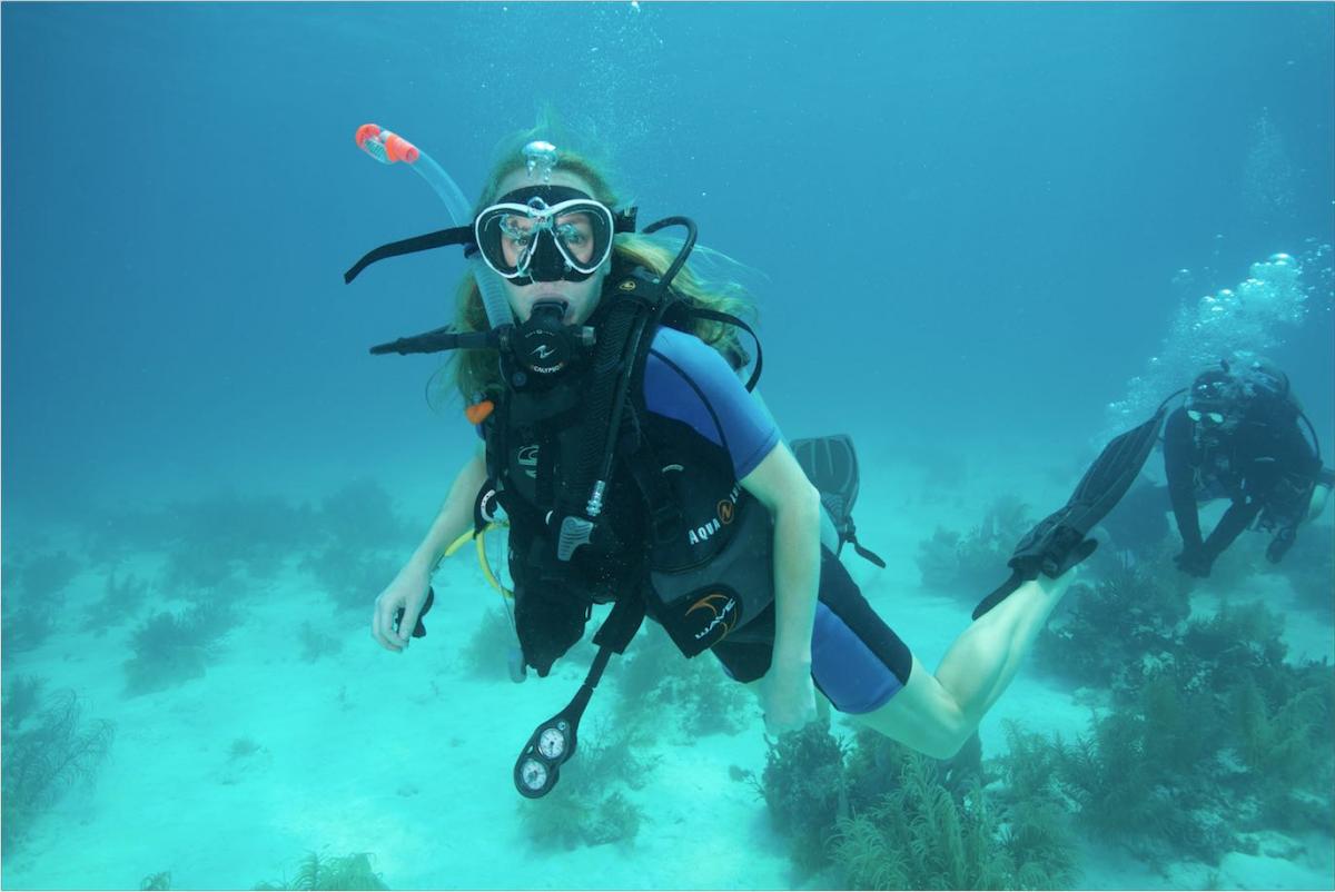

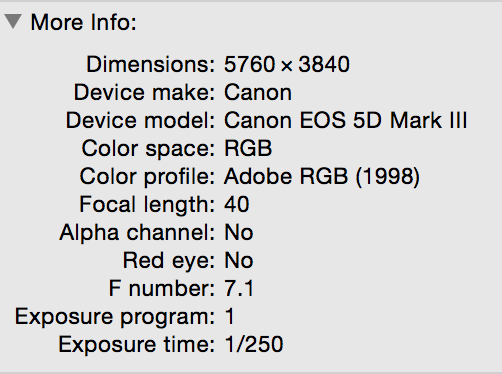

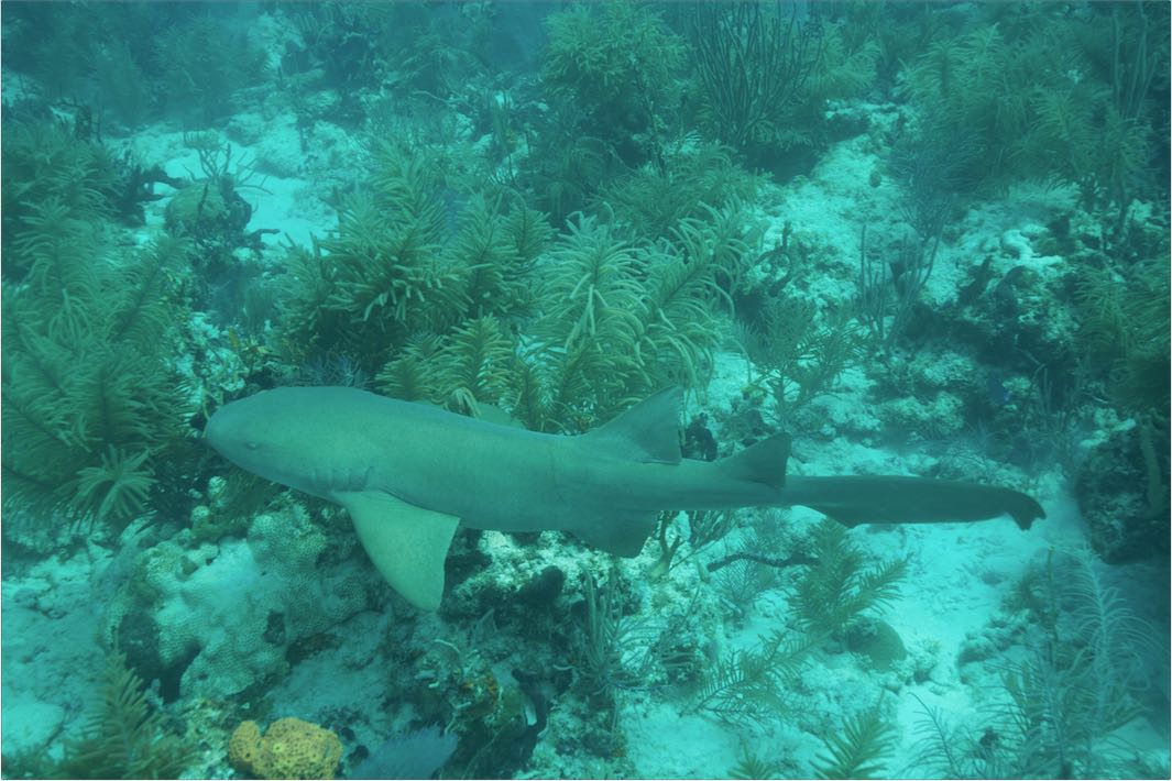

  9. Ok, sorry took me awhile (this is my first photo upload). These are pretty crap, but you can see what I'm talking about. 1/250 I know is a tad high, but it should still have a semi-decent result, no? ALSO, love the clark miller strobe attachments, sucks about it cutting your light, but with these it might work since they're more powerful than this old gal is used to.

    Your shutter speed is set really high, unless you're shooting sunballs, I set it more like 125th/180. I'd try to get it a little closer and position your strobes a bit closer, you simply aren't getting light on your subject (at least in #1).
    I experimented with the 100 vs 120 diffusers and found the 120s are simply too wide, I was getting backscatter on the outside edges of my shots no matter how far away I positioned them. The 100's are fine and with power set to 2/3rds you should be able to light up the world.

    I agree that the shutter speed is high. I would also point out that your aperture seems pretty stopped down too. What were your ISO settings?
    Overall, the images are a little overexposed. By reducing the overall exposure, you would get better color rendition
    The blues are very washed out. What are your white balance settings? I would suggest trying to balance out camera settings with the strobes' color temp. The YS-D1's are 5250°K.
    I think the issue here is more to do with the camera settings than the strobe's output?

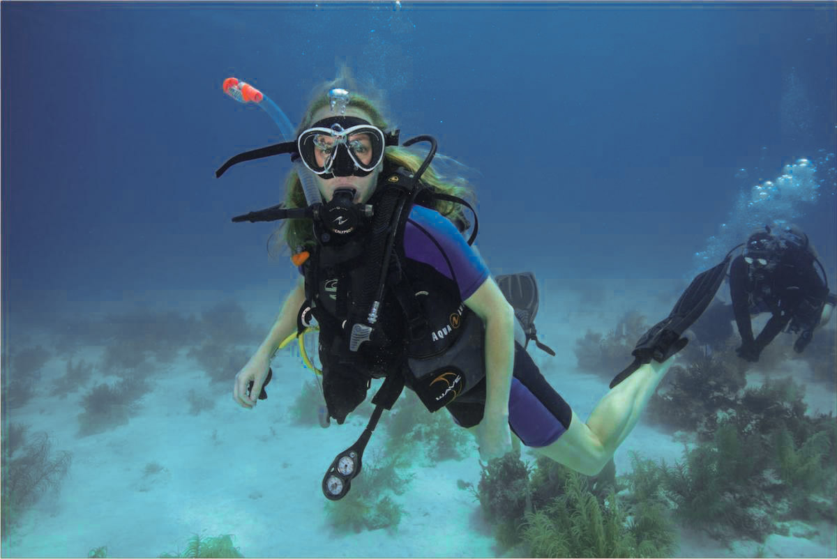

    I have played with them second image in Photoshop quickly. Mostly just white balance, exposure and color saturation:
    I do think that the model does need some more light on her, and increasing the strobe output may be one way of doing so.

    Looking at your pics and if you say you had the strobes at ½ and ¾ power, then they can't be working right, assuming you used the correct lighting technique. The pic of the lady seems to indicate your strobes were pointed up.
    As an aside, the 5D3 flash sync speed is really 1 / 200. In manual, you can go above but you will get a slight band at the bottom of the pic and also catch less light.
