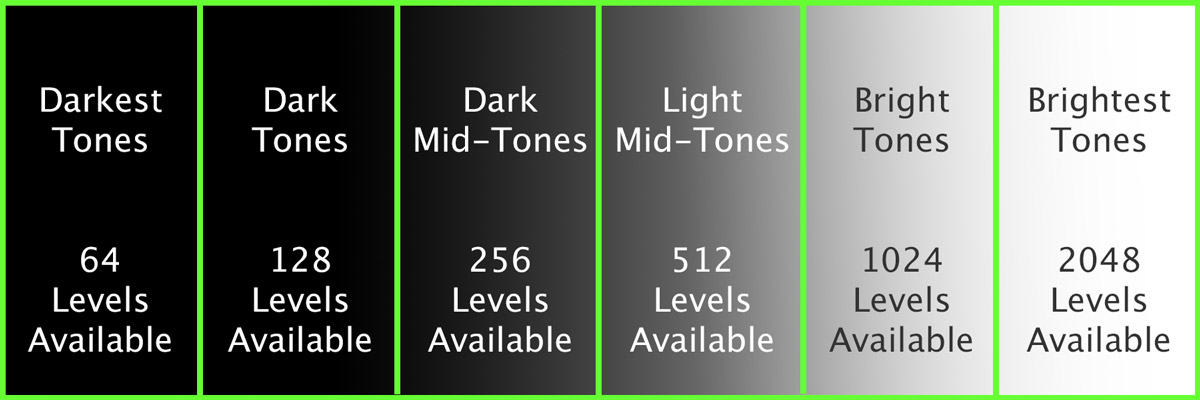

    Managing the dance between shutter speed, f-stop and ISO can be complex. I used to do everything possible to avoid raising the native ISO, but I've changed my ways. Though most newer cameras are built to handle high ISO magnificently, the sensor still collects data in the same linear fashion, with 2048 of a possible 4096 (12-bit RAW) tones collected in the brightest stop. That means that underexposing (no ETTR) can result in a hefty potential data loss. I'm not advocating blown highlights here. Lightroom can restore almost 2 stops of highlight data, but nothing kills a shot faster than a blasted sunball or badly clipped highlights.

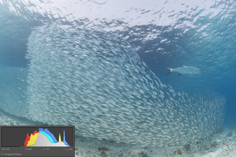

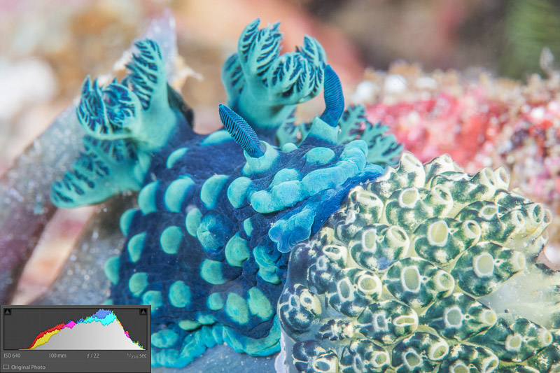

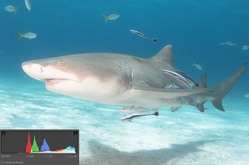

  8. Here's one that wouldn't upload in the last post...I'll post the edited versions when I get a minute :-)
    Edited by LauadiBaby

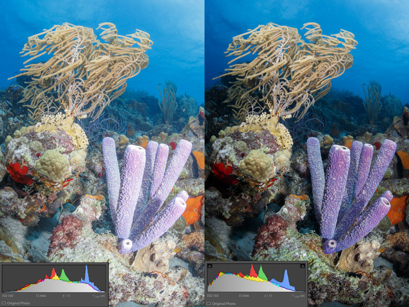

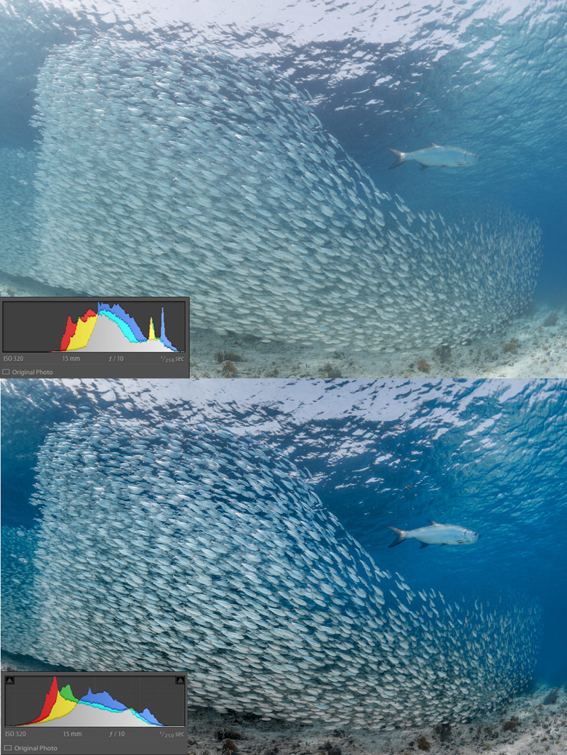

  10. I'm shooting a Canon 1DX - I'll ask my pal at Canon what he thinks. Even though the Digic 4 is 14 bit, I think the sensor still collects data in the same fashion, so although the numbers of available tones would change, the percentage collected for each stop would remain the same.

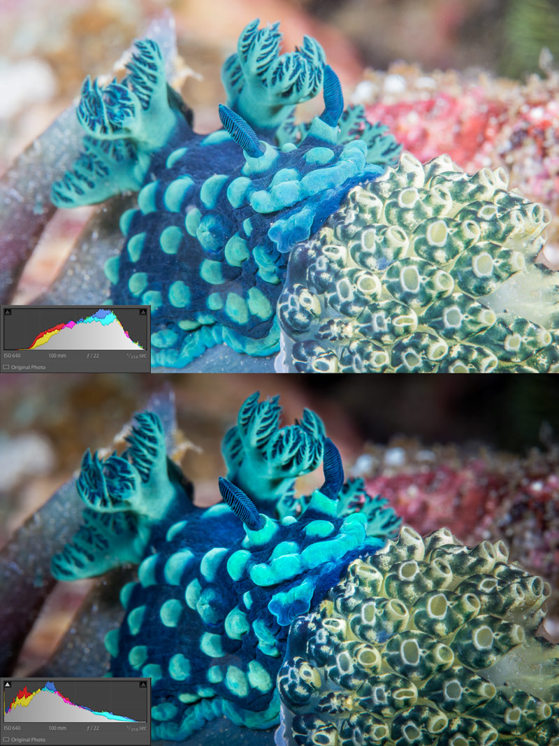

    In the meanwhile here are some before and afters, histograms included.
  11. Thanks Erin,
    How are you "correcting" the exposure in post?
    Adam
  12. Interesting topic. I find I'm much more tolerant of too dark spots in my final images than I am of blown out highlights. As such I tend to take the highlights as far up as I'm comfortable with and use that as my measure of the "correct" exposure in camera. Then I routinely pull the highlights back just a little bit using Lightroom. I also think that overly dark images in camera can often reveal way too much backscatter when lightened up afterwards.
    And the fact that I'm normally shooting in the dark means the glowing camera screen can make the image reviews look brighter than they are. After tripping over that fact a few times I now try to increase the exposure in camera to compensate, especially when I've just taken a shot I really like.
    So overall yes, I do aim for exposure a little bit right of the middle, but not particularly far. I like your post-processing Erin - a good view of leaving the subject bright and clear and pulling the background down a bit.
  13. Laudibaby i think your before and after images speak for themselves are they all just exposure corrected as the shark shot looks sharper and the Nudi seems more vibrant. would be wonderful if that was all from just a simple adjustment to how we shoot. i will give it a try this weekend.
    thank you so much. :notworthy::notworthy::notworthy:
  14. I think to is important to note that in Erin's images above, she has not blown the highlights. All the image info is contained within the histogram, there is no clipping. The principle of ETTR is that exposure is shifted towards the right, but not clipped.
    I don't think that an LCD is suitable for judging exposure. In order to get accurate exposure, it is crucial to consult the histogram.

  18. Erin, nice set of before and afters for sure. You have really done a good job to bring back the colours. I am also interested to know your methodology. I would simply just pull the Highlights and exposure sliders down but I have a feeling there is a lot more to it than that!
