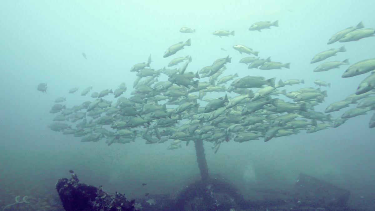

  2. I've tried to white balance my GH4 down at 48m (single frame attached - unedited, but down sampled and jpg'd) - however the colours we shot (completely off) - which makes sense being that deep.
    Had issues with my EPL3 before which even in 15m, it would Error trying to white balance, so it shows at least the GH4 gives it a good go.
