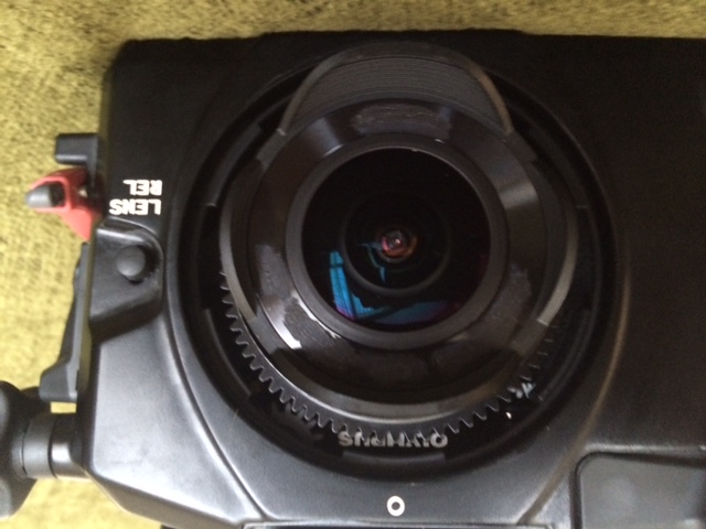

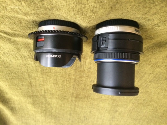

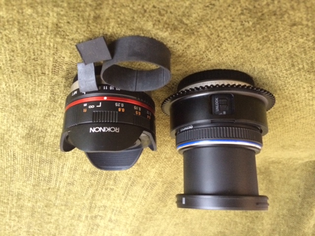

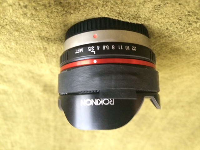

  7. Hi! I find that it's still important to be able to focus during the dive. It's very easy to put a focus gear on the Rokinon lens.
    Please see the pictures below: (sorry for the bad picture quality, not sure why the images are posted up side down)
    Oly 9-18mm lens with Nauticam zoom gear
    Rokinon 7.5mm lens with rubber band and "shims" (cut from a motorcycle tire inner tube)
    Rokinon 7.5mm lens with rubber band and "shims" mounted on the focus ring
    Rokinon 7.5mm lens with Nauticam 9-18mm zoom gear mounted (just the outer ring)
    Rokinon 7.5mm lens in Nauticam EM-10 housing. Focus can be adjusted with the zoom gear!
    Hope this helps!
