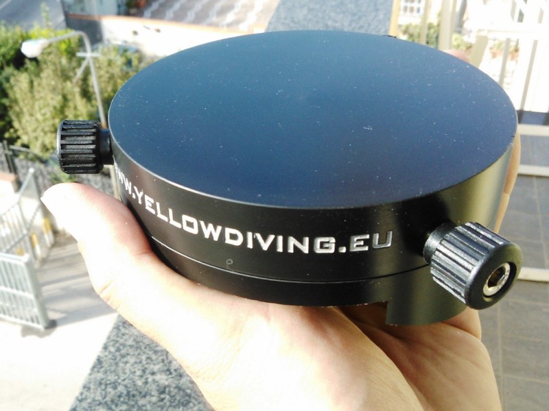

    This is my YellowDiving mount. You have to add a belt and one or two holes based on your camera:
    http://wetpixel.com/forums/uploads/monthly_09_2012/post-32954-0-16804100-1348439744.jpg
    The 3 screws on the head keep the camera in a fixed position or let it rotate while still keep it on the mount. The cons with this nice piece of kit is that if you want to mount/unmount it in the water or underwater you have to loose/tight all of them. It's not so easy especially if you gear is big. It could be difficult reaching the screws with your finger. For this reason, usually I prefer to mount everything on the boat.

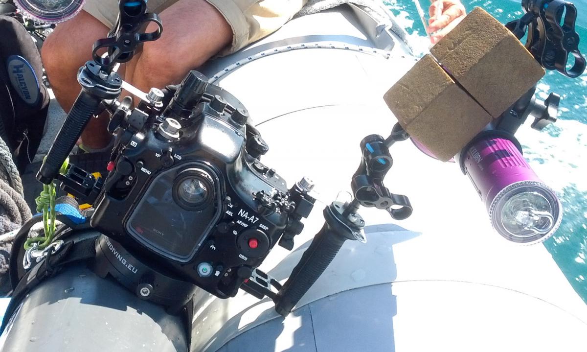

    As you see on this photo of the AN-A7 two of the screws are far form reach behind the dome. I was forced to that position because the dome is larger that the housing and very near to the tripod mount hole.
    You can see my GH2 on the Yellow diving mount.

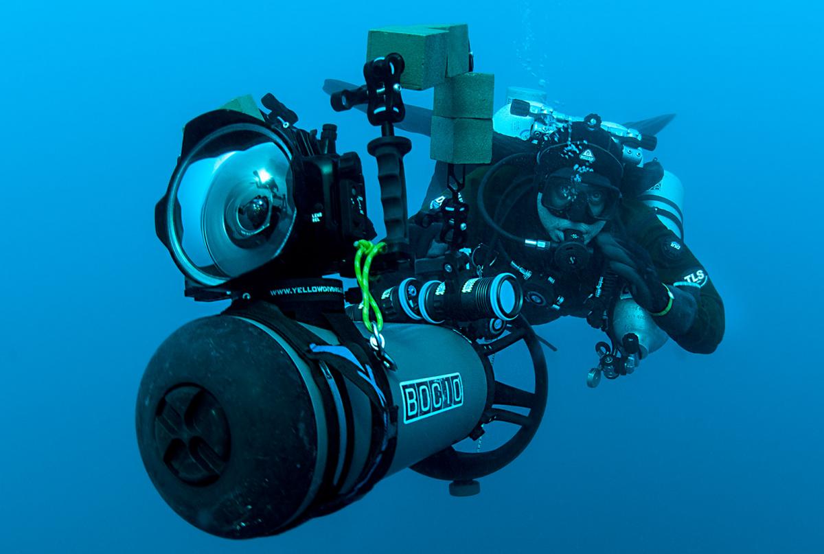

    Once you make your camera rig (housing + lights) nearly neutral buoyant, getting rock stable shots with the scooter is very easy. I like to keep the camera aligned with the scooter handle so I can eventually shoot while scootering. The whole rig (camera and scooter) is so stable that you can shot moving everything with one hand.
    The only PITA is that you have to set the camera and press the trigger and then keep filming while far from it. But I become very good to stretch myself toward the housing with one arm to adjust settings :)
