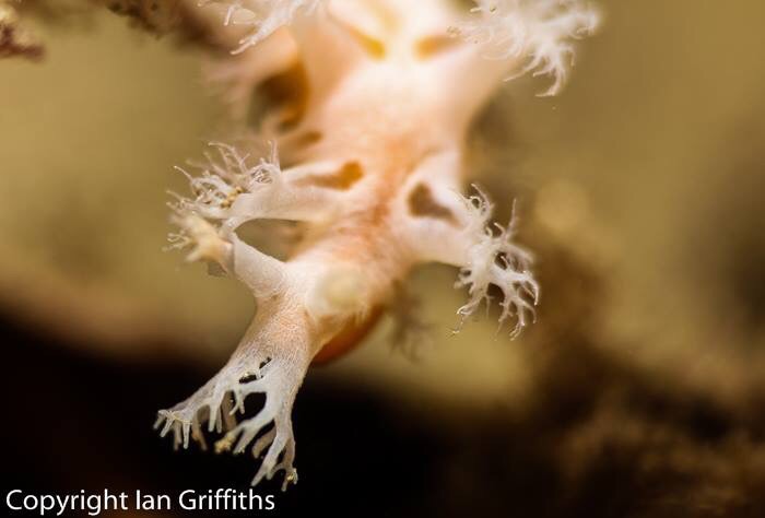

  7. Thought I would try my new Nauticam CMC I got for my OMD cameras with my Canon 700D with Canon 60mm macro lens in Nauticam NA-600D housing with new vacuum valve and circuitry.
    Nudi is a juvenile only about 10mm long.
