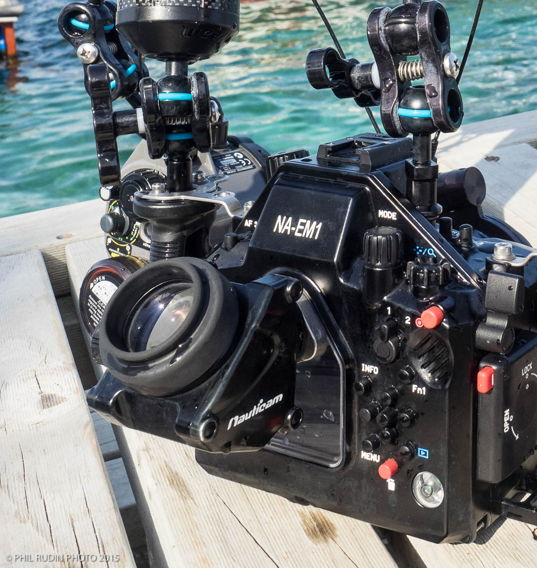

  5. I am also a big fan of the 45 finder and it is a great asset for macro. Yes, the back window needs to be replaced with a new one that has support for the 45 finder, it is around $240.00 US new. It is user replaceable and takes less the a minute.I am selling the window for the NA-EM1 housing if anyone in the US is interested , send me a PM.
    Edited by Phil Rudin
  6. Thanks Phil for the Picture. Good to see that there is somebody using the viewfinder in combination.
    It Looks like that it makes sense to use only the viewfinder with this combination. The view to the backside Screen is not really possible.
