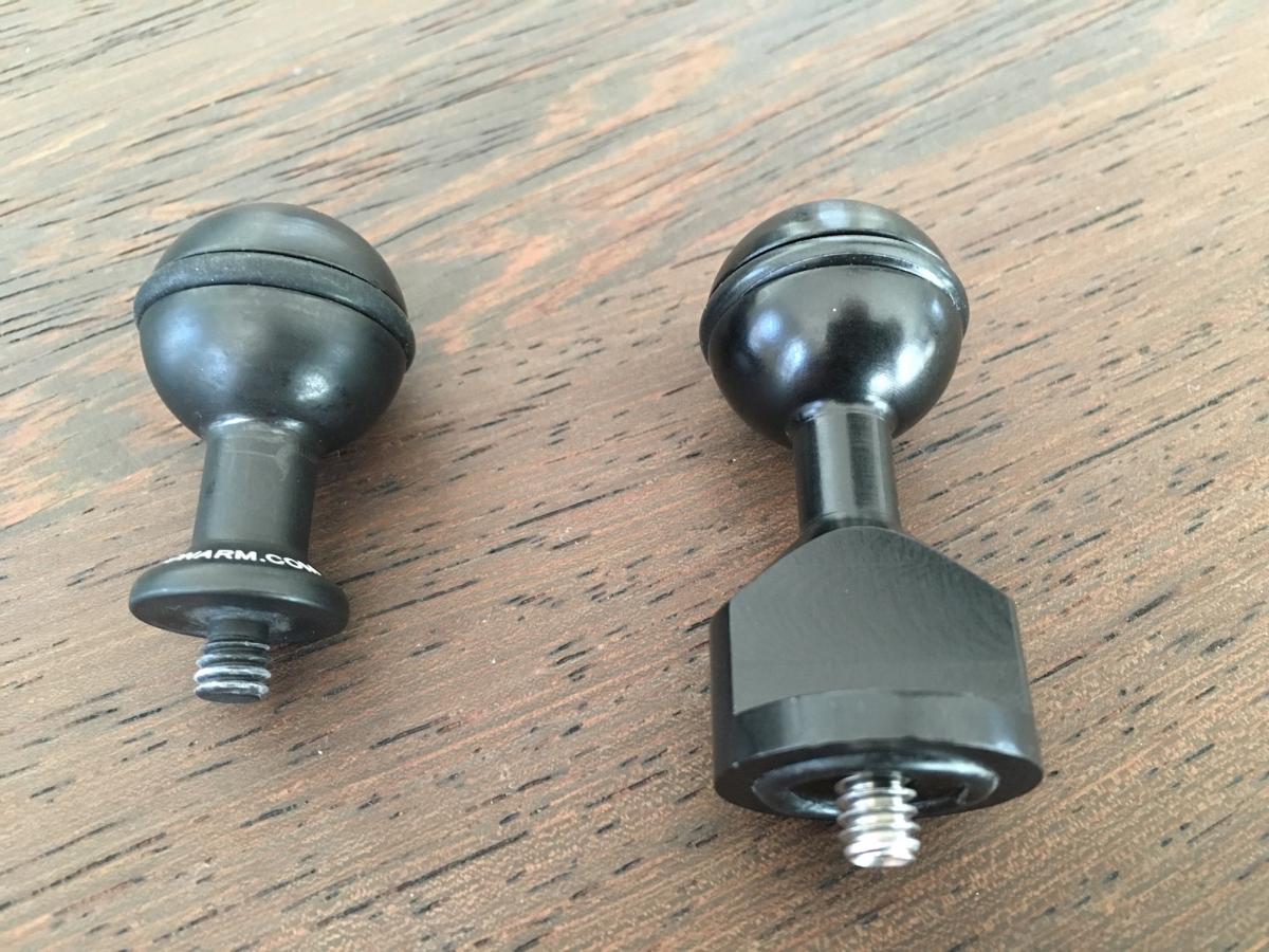

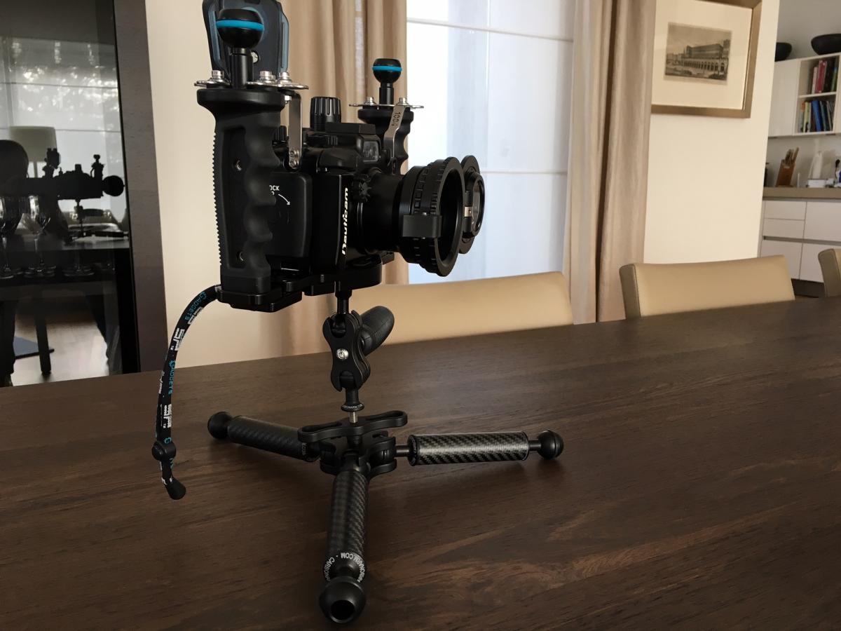

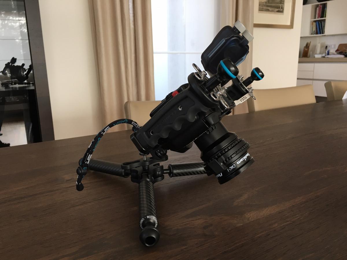

  14. Many thanks Leo for sharing your tripod. I now actually decided to get the one from Easydive. I only slightly modified it as the ball adapter to screw into the tray which came with it looked a bit flimsy (bottom picture, left item). I replaced that by the ULCS adapter which has an o-ring around the screw and can be tightened really firmly to the tray (bottom picture, right item).
    This tripod allows you to go pretty low (3-4cm to table top) for macro objects. Haven't played with it in the water yet, though.

  15. The easy dive legs look to short and too close. For a single leg like that you would need something longer. Or if you want to use 5" segments they need to be more spaces apart like the Leo one
  16. The legs are actually 7" - but if that proves to be too wobbly I can easily replace them by using 10".
  17. I like more when the centre of gravity is lower. The issue with single point tripods is that you need to have fairly long segments which in turns can be tricky on uneven bottoms. I like my mechatron tripod that is not actually a tripod. The best thing is that you can fold the legs up and is not much more bulky then a tray. I also think monopods can be very useful
