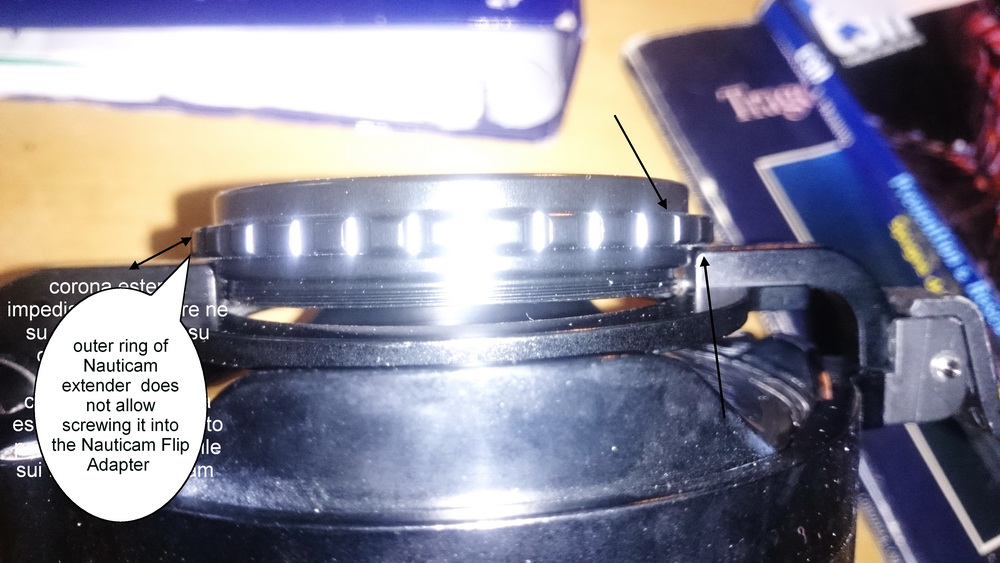

  1. I just purchased the CMC-1 macro lens from Nauticam. I already own a number of ports and I also own the 4" dome port which I use more now with the 12-50mm lens and 60mm olympus macro.
    I have used successfully the UCL-02 I-Das macro on the flip adapter to get reasonable macro on the 50mm focal length and some super macro on the 60mm one.
    However I expected the CMC-1 lens to fit as well and it does not as it protrudes back too much. The extender included in the CMC-1 package would make it work but the outer ring does not allow it to screw it into the flip adapter (any flip adapter from Nauticam it seems as I tried on another 67mm one as well). I attached a photo.
    Has anybody tried this or found some adapter to allow extension to fit the CMC into any Nauticam flip port?
    Andrea

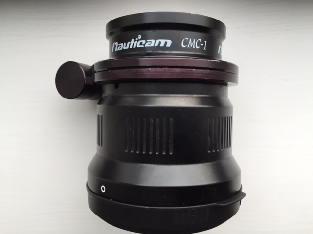

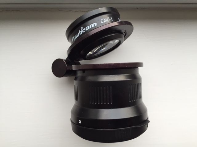

  2. Hi. This may not help, but the SagaDive Flip Adapter takes the CMC without the extender ring without problem. The rear of the CMC just clears the port glass with fairly optimal close positioning. The newer style 67mm securing ring from SagaDive is needed as their original style one did obstruct the CMC.
    See photos below.
