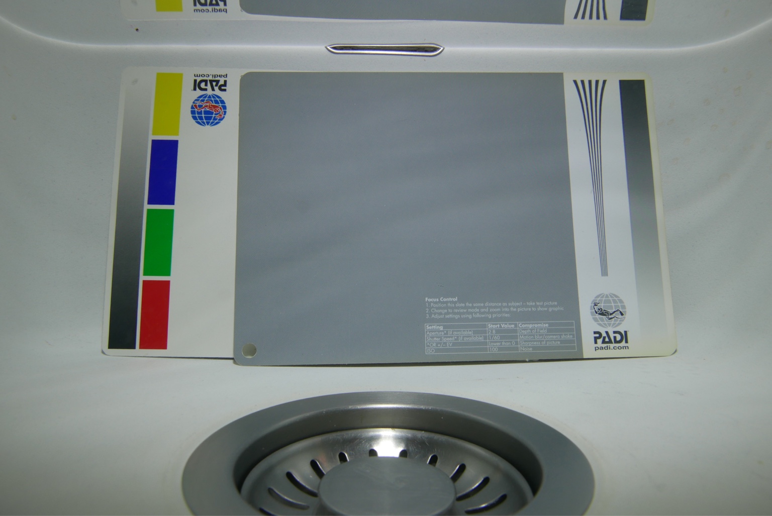

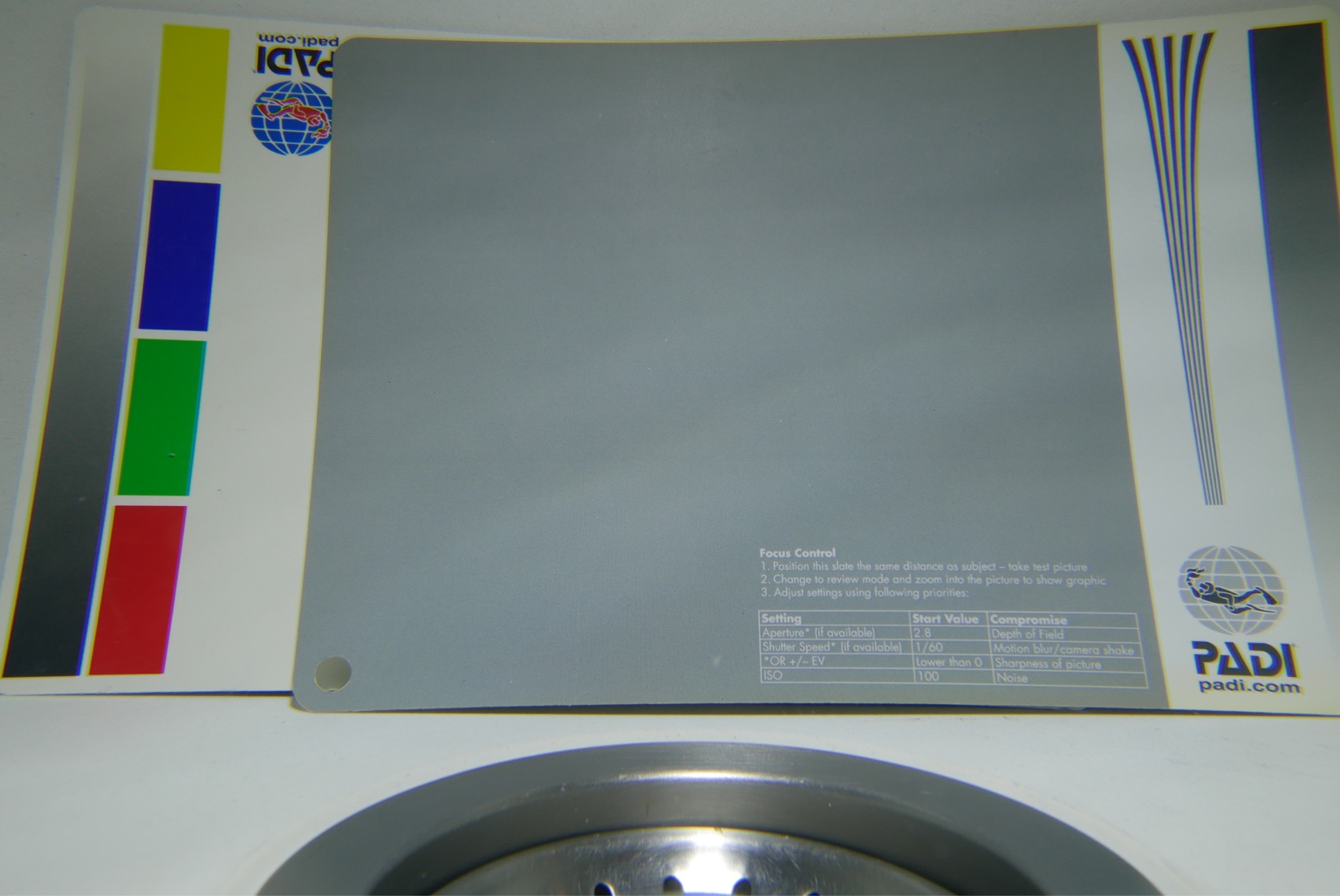

    To give an example the two images here are both at 24mm one is with flat port and the other is dome
    Underwater this gets unnoticed less unless you have a person or a wreck but if you try and look at the image on a large screen the defects are obvious
