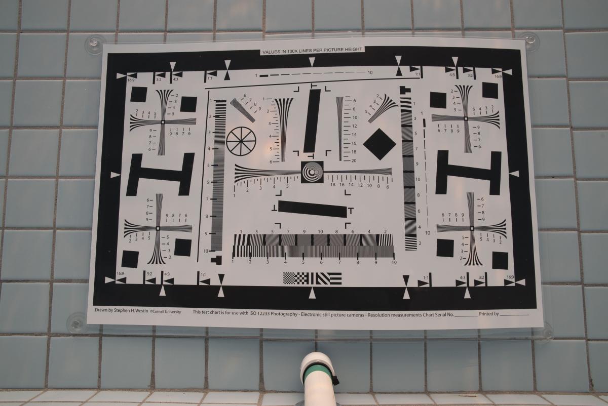

  1. I took this in a pool a few weeks ago:
    Sony A7, Nauticam NA-A7, Nauticam 180 viewfinder, Nikonos 15mm
    Apparent distance 1 foot (measured), f/11, 160 second, Manual Mode, Auto ISO @ 200
    Focused with Focus Peaking.
    I was looking for corner sharpness with rectilinear lens, avoiding use of a large dome.
    (I had a little trouble getting the target flat due to spacing of the suction cups vs grout lines. The grout in the corners may be the best indicator of sharpness.
    I can't post a JPEG larger than 1000kb)
    I was looking for a relatively lightweight, rectilinear wide angle travel rig.
    The orange discolouration is sunlight filtered through forest fire smoke, filtered through pool water:(
    Looking for opinions, suggestions, comments and discussion:)
  2. Looks great - sharper corners than 99% of uw shots I've seen, however to comment, we need the full size:)
    I need this lens on an Ikelite housing :cake:
  3. Hmmmmmm. So when the A7 + Nikonos 15mm are considered against full frame DSLR for wide angle underwater...
    Pros:
    Beautiful corners
    Slightly smaller rig
    Much smaller dome/lens on the front
    Cons:
    Battery life
    Manual focus only (not much of an issue on the 15mm)
    Negatively buoyant?
    The cost of change
    I have to admit to being slightly conflicted on my next upgrade, and hoping that what Canon does with the 5D4 will give me an easy decision. Having a 15mm Nikonos lens kicking around doesn't help either!
