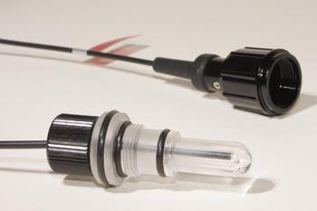

    I see that hugyfot produce an acrylic conversion the replaces the inner workings of the standard nikonos bulkhead, looks like it screws is and seals using the standard nikonos internal oring and and oring placement directly onto the bulkhead itself.

    They are located just off to the left side of the top centre of the housing. The hugyfot converters I found on some other posts, basically strip out the standard nikonos bulkhead (easy to do) and screw in the optical acrylic unit. Found on the web for 55 euros.

  5. This is the conversion in question
  6. the hugyfot connectors are a great idea, but your challenge will be to capture enough light to trigger your strobe. They are designed to work with a flash trigger and not LED trigger.
    As already indicated, LED triggers are very position sensitive as they barely provide enough light. They need to be placed close to and pointing directly towards the end of the fibre optic cable. This will be a challenge with your housing as the bulkhead connectors are the low clearance design used when space was tight inside the housing.

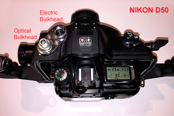

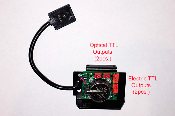

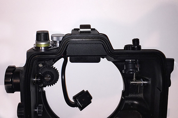

    Last month I installed him new TTL device into the housing and optical bulkhead. Electronics supports Optical TTL and Electric Wire TTL. This TTL-Converter is electronics scheme with firmware (initial shape PCB is a serial product which "UW Technics" company suggests for Nauticam housings). But the concrete PCB for old Nikon D50 housing was custom made by manufacturer via our special order. Manufacturer gives possibility to order custom made PCBs, if you have dimensions or a sample PCB shape. Price is almost the same as for serial product, just a little bit more. So, it was a custom made Conversion Kit which included Electronics, Optical bulkhead with built-in LED, bulkhead adapter, and etc. If you need 2 optical bulkheads, it is also available. That was a set for easy installation by user. I installed it in 15 minutes. I changed 1 electric bulkhead to optical bulkhead, as you see on the picture.
    This device works with fresh battery - 5 years, or 75 000 flashes. Switch ON/OFF - automatics (by the camera command), no need external sealed switch.
    Compartible strobes - Z-240, D2000, YS-D1.
    Currently TTL works perfect with that Nikon D50. Camera recognize the device as nikon TTL flash (look to last picture "TTL flash" symbol on the display).
    Now my friend use mainly the Optical TTL with Z-240 strobes by fiber optic twin cable, sometimes Electric wire TTL by 5-pin cable, and sometimes mixed variant. Very wide possibilities.
