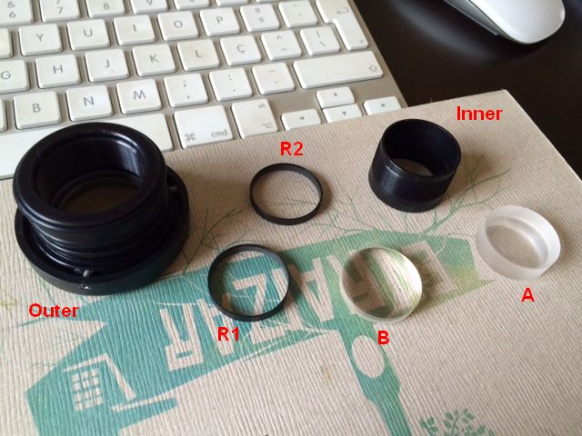

    I have an Aquatica Housing and I had the eyepiece out from it, my kid dismanteled it, and now I do not know exactly how to mount it again.
    I have asked help to Aquatica, but I did not get an answer yet, and as I need the housing to go dive, I am asking here for your help.

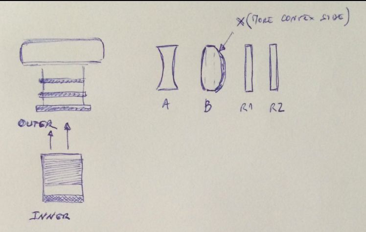

    What I need to know is the right order to put the different elements inside the "inner part".
    Picking up the inner part with the side that is looking to the eyeview of the camera facing down, what is right the sequence of puting the other elements in it.
    Please see the schem with the parts identification. The ring spacers R1 and R2 are equal. And the "B" part, the more convex side is facing down or up?

  2. We perform Aquatica maintenance here in Finland and I checked from my notes of a similar eyepiece the following order, from the outside inwards:
    1) outer lense with O-ring (you seem to have this still in position)
    2) black metal spacer ring R
    3) convex lense B with convex side pointing towards the outside
    4) black metal spacer ring R
    5) concave lense A
    Remember to clean your finger prints from the lenses...
