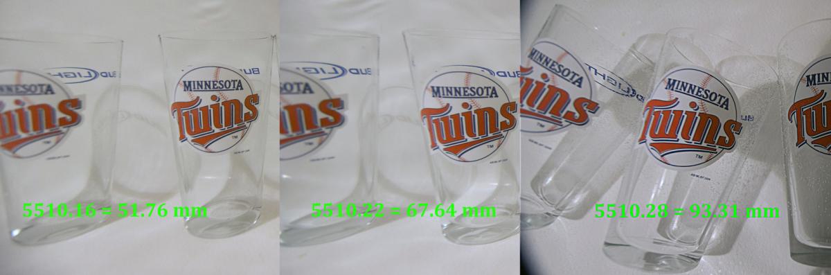

    Sample Photo Showing cropped photos (to left side) of my Test results. Keep in mind the optimum zoom for the last photo would have been somewhere between 10-20 mm and not right at the 10 mm I shot but I wanted consistency. From left to right goes what other photographers suggested, middle was the manufactures best guess and right was what I calculated.

    Again, I opted not to go with the extension 5510.28 even though it's likely the right length because it was visible in frame at 10 mm zoom. It did provided more clarity then the other extensions tested but it wasn't worth it to me at the time. In hind site is was a rookie mistake to worry about the zoom function instead of just setting my lens to 12mm before diving. You can see what I mean in the sample photo.
    So what do you think, did I get it mostly right or would you go back to the longer extension and slightly zoom the lens?

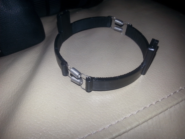

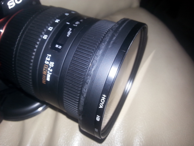

  5. Could you please post a picture of how you modified the lens?
    Interesting work, I considered buying a rectilinear ultra-wideangle lens once but ended up buying the Sigma 10/2.8 diagonal fisheye.
  6. Absolutely... in hindsight that would have been the most obvious picture to show.
    Sent from my SCH-I535 using Tapatalk
  7. Could you please post a picture of how you modified the lens?
    Sorry for the slow response.
    You can see where I shaved off the ring that normally is used to mount the shade.
    This is an unmodified zoom ring grip, all I did was cut off the springs because they were too fat.
    Update: ikelite started making an extension that is likely the perfect distance (between the best two above) so it shouldn't show the port at 10min. Going to check it out this weekend or next.
  8. Thank you for the image and description. I think this is a good solution. If you still want to use a shade for topside shots you can as well use some generic screw-in shade.
