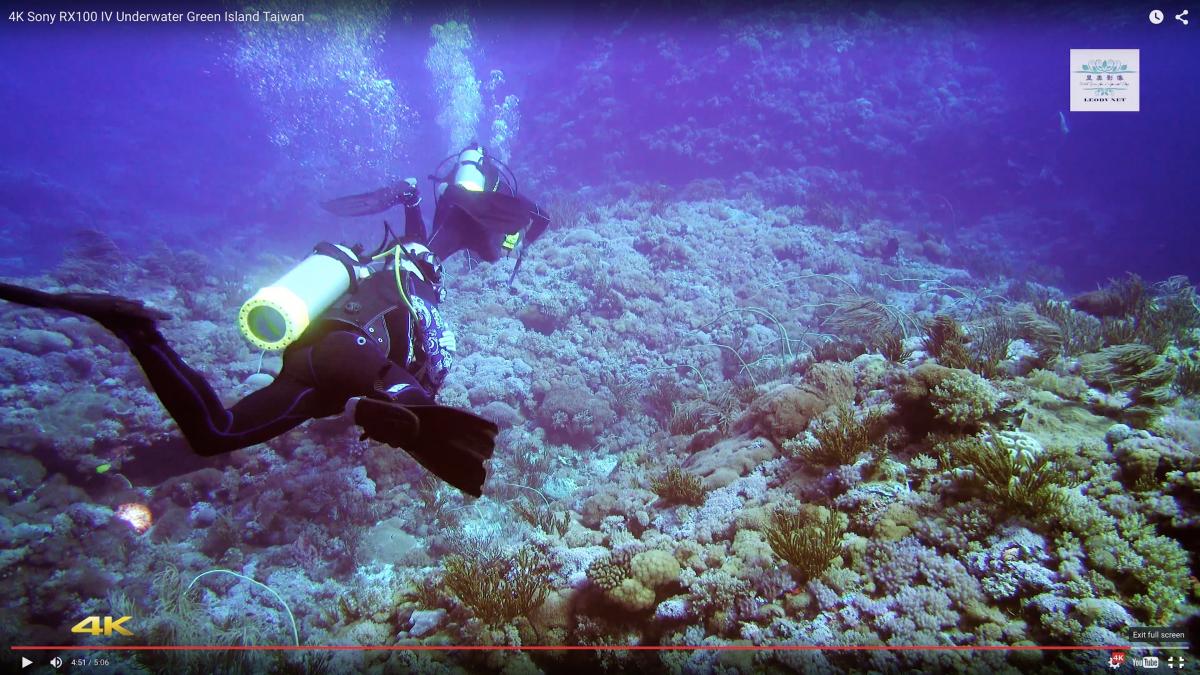

  1. this video was shot at 4K resolution, by sony rx100 IV with Marco diopter Subsee+10, and 10,000 lumen lights X2, and did some post production color correction and so on.
    Location: Green Island , Taiwan
  2. Leo, some nice macro in LuDao. I have a question:
    A few of the wide angle shots had a lot of magenta cast, at least on my screens. What kind of post did you do and with which program? What was the original like?
  3. u are really good of ur eys sharp, yes, some of those shot i corrected not perfectly, i am lazy to shot in custom WB underwater, i will do color correction after i back home on software.
    i use premiere pro CC 2015 to work with it
    although, it's not for sale, just for personal creativity
    i capture the original pic for you
    thanks for ur comment

  7. The RX100 in the standard mode pushes blue towards deep blue and magenta to deeper magenta
    So when you shoot with a filter in auto you need to dial down the blue and add yellow and green
    I have had the same issues before working out the right settings
    However the new RX100 has also picture profiles and the profiles PP3/PP5/PP6 or PP7 slog2 will not have this problem
    Profile PP1/2/4 and off will have the over-saturated blue and magenta and weak yellow

    To a certain extent underwater white balance is a matter of taste, so there is no definitive right or wrong. I like near things to look pretty much like they would if they were lifted to the surface. Others prefer a more cyan look. I can't watch your video on my current connection but judging by the stills I see above, your WB is way off what I personally like it to be. It looks so skewed towards blue-purple that you will have problems trying to "correct" it in post. You're not shooting RAW or 10-bit 4:4:4. There's only so much you can do.
    You don't need to WB every shot, but I like to white balance with every few metres change of depth. You don't necessarily need a white board. You can white balance on the palm of your hand, or on white fins, or on white duct tape on your fins etc.. None of these will be exactly right, but they'll be much closer to a pleasant white balance than what you're doing now. Experiment and test. This very old post (see post #147) on some white balance testing I did with my Sony Z1P may give you some insight and ideas, but bear in mind that those old Sony 3CCD video cameras were more predictable in manual WB than many of the more recent Sony cameras.

  13. Sony Cameras tend to fail custom white balance in water and tend to work better with filters this has been the case with all previous versions of the rx100 and I am not sure if there has been any improvement also the custom wb button is not available in video mode
  14. Sony Cameras tend to fail custom white balance in water and tend to work better with filters this has been the case with all previous versions of the rx100 and I am not sure if there has been any improvement also the custom wb button is not available in video mode
    On my last trip to Egypt I did one dive filming without using the redfilter on my RX100iv - and the results were pretty awful. Pretty much unusable even after post correction. So I don't think anything has been fixed on the mark IV on this respect.
    However, using a URPRO redfilter and AWB the clips look very good. Therefore I'd recommend to always use a filter when filming with the RX100iv
    Edited by bubffm
  15. I have tested all possible filters with the RX100 see post on my blog. The best colours are magic filter the URPRO gives some yellow cast. I use a mangrove/deeproof filter that has a magenta cast. Either way the key is to use auto white balance and correct the tint. Manual white balance is off even with the filter
  16. ok, I didnt really notice any yellow cast but I'll give the Magic a try the next time. As this is a foil system, where would you place that? In front of the lense of the RX100 or into the housing itself?
