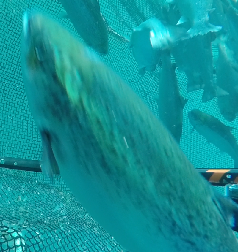

    I'm currently working on a project with Salmon fish in Norway.
    The goal i to have a high resolution and very sharp picture of a fish moving in front of an underwater camera in the Fjords.
    I tried with a GoPro 4 using high FPS video , "normal photo ", timelapse etc. and I always end up with a blurry picture (see attached for example).
    I thought about different ways to do as :
    - Use lights with fast shutter speed : Problem > I must not have any light reflection on the fish skin
    - Move the camera while the fish is moving : I tried at my office with a simple object, I got sharper image but it still blurry
    - Use a very high speed camera (1000fps for example) : Didn't try that
    - Use a very high ISO camera like the Sony a7S II : Didn't try that
    - Use a special algorithm for motion blurry (http://cg.postech.ac.kr/research/fast_motion_deblurring/) : Try it, a bit sharper but not enough
    What would be according to you the best way to do so ?

  7. The issue with the GoPro image above is that the subject (salmon) is too close to the GoPro and the camera cannot focus on it.
    This can be corrected by using a correction lens (http://wetpixel.com/articles/field-review-inon-gopro-accessory-system) or a camera/lens combination that provides close focusing ability (there are many!)

    you have a couple of problems:
    Firstly you are too close to the fish to get a sharp image as the minimum focus on the gopro's is around 12 inches or more. This can be partially addressed by fitting a close-up lens like a +10 diopter to the front of the camera and perhaps using the camera in medium view mode. This diopter moves the whole focal range a little closer whilst still maintaining great depth of field. It's not the same as a macro lens, which will get you closer but has a very limited depth of field and is less useful in this situation. You will need an adaptor plate to fit the front of the camera with a 58mm thread to take a slightly wider diopter.
    Secondly you have no control of shutter speed with the gopro so if you don't have great light, the shutter speed won't be fast enough to freeze the action. The white streak in the centre of your image shows you the shutter was open too long and allowed the particle/bubble in the water to travel and blur in the image (also the fish). I don't know which Hero 4 you have but you might have an option to shoot video in 4K and then take a still from that, shooting video will force the camera to expose 25-30 frames per second (and hence shorter shutter times) rather than a longer exposure for a photograph, however you will still need good light, which I think is your underlying problem. From the iimage you posted it appears you are working at some depth so light is going to be your biggest issue.
