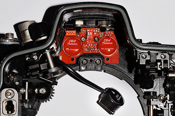

    For accurate TTL i advice you to try "Optical & Wire TTL-Converter" (edition for Nauticam housings), made by "UW Technics". This is the 1-st product on the market which provides optical TTL, wire TTL, and mixed TTL in one device. You can use fiber optic cables, 5-pin synch cords, or both together. TTL works accurate with all types of synchronization. But I recommend you optical TTL, as progressive nowadays.
    I tested this device for Z-240 and YS-D1 strobes with my Nikon D610 in Nauticam housing. It was on the Red Sea in October. Automatics worked perfect, without any correction +/-TTL.

  4. There is a video on Youtube about TTL-Converter mentioned in previous post. Test for Nikon camera in Nauticam housing with Z-240 strobes.
    https://youtu.be/qmzp64Hivn4
