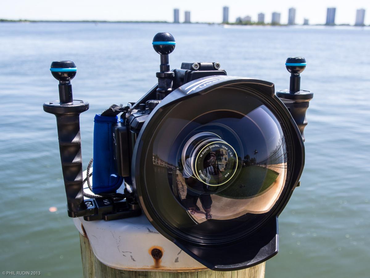

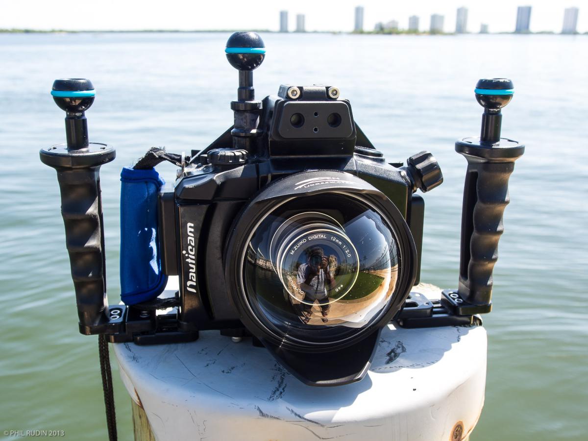

  4. I really like the Olympus 12mm F/2 and have used it often for split images using the ZEN Underwater 170mm optical glass dome port type I (without the extension used with lenses like 7-14 and 12-40). Corners seem sharp enough to me but I find corner sharpness to be quite a obsession for some.
    The image is with the Olympus E-M1, Nauticam NA-EM1 housing, ZEN 170mm port, 12mm F/2, ISO-200, F/5, 1/2500th, shot in aperture priority, center-weighted average, ambient light.

  6. These are the two port I have used with the Olympus 12mm F/2, both Zen Underwater the original 170mm and the 100mm used for the Panasonic 8mm fisheye.
