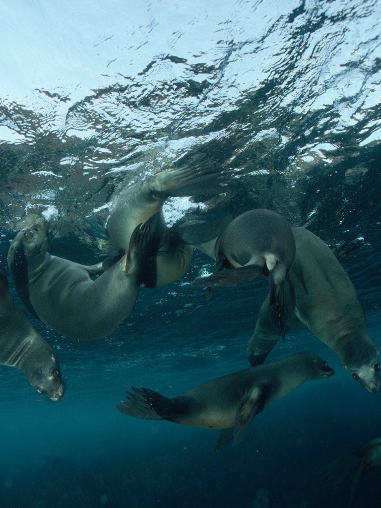

  1. Hello all,
    I have seen this mentioned somewhere before but could not find by searching.
    Is there an aspect ratio or image size setting in Lightroom to show the ENTIRE RAW image?
    I happened to open a RAW file in Windows Photo Gallery and it is larger (as in wider / taller) than what is visible in Lightroom.
    Would this additional part of the image be accessible in Lightroom?
    The difference is not large, but for images of fast moving critters who are at the edge, or out of a shot that additional height and width could improve or save an image. (not necessarily this one as the sea lion still too close to edge of frame)
    Any suggestions?
    If it makes a difference I am using LR 5.7 and am shooting an Olympus EM5 in RAW only
    Not sure how to manipulate images on this forum so they have different orientations for some reason? The upper image is what is visible in Lightroom, the bottom what is visible via Windows Photo Gallery
    Thanks in advance,
    Adam

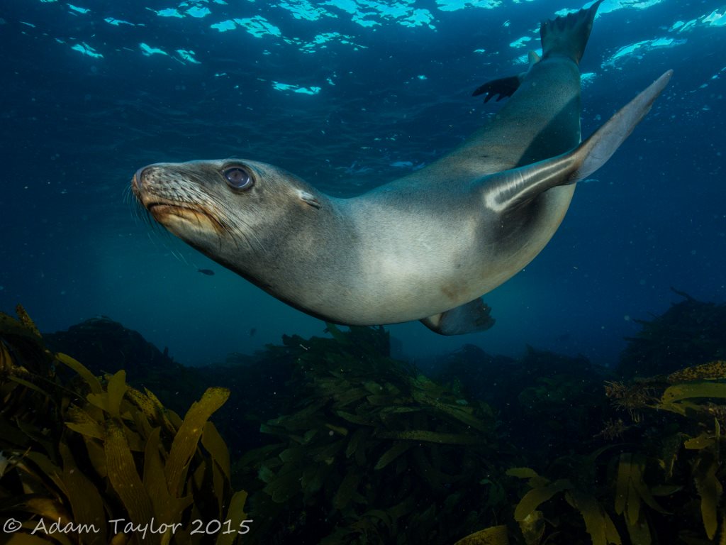

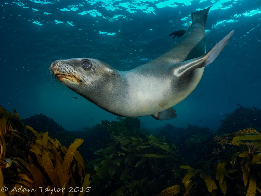

  3. Thanks Tim,
    Just tried your suggestion and it did not reveal the outer edge. Same image, just showed the various crops or zoom within the original image size.
    The top image is what is is visible in LR and is compressed from the JPEG exported by Lightroom. Along the bottom (long side) of the image the sea lion has only one eye visible. There is also one full & one partial fin barely visible in bottom corner
    The bottom image is what is visible using Windows Photo Gallery which I used to convert the ORF file to JPEG. Looking at the right side of this image you will note that both eyes are now visible on the sea lion and that both fins are visible in the corner.
    So my question is - can Lightroom access this full image as it will make a significant difference.

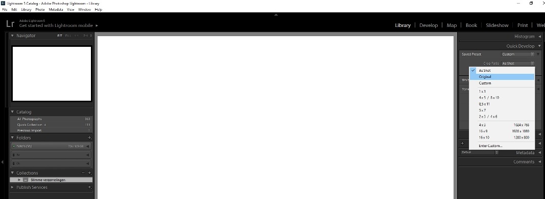

  6. Adam,
    I'm assuming that your camera is set to an aspect ratio of 2:3 instead of the native 3:4 of the olympus sensor.
    When you load the RAW file in LR the crop ratio used to present the picture is the same as the camera setting (as shot), despite the fact that the RAW file is larger. When you change the crop ratio to original (see picture below) the whole RAW file will be presented to you.

  8. _alex_ said check/change the crop ratio in the CAMERA not in LR ;)

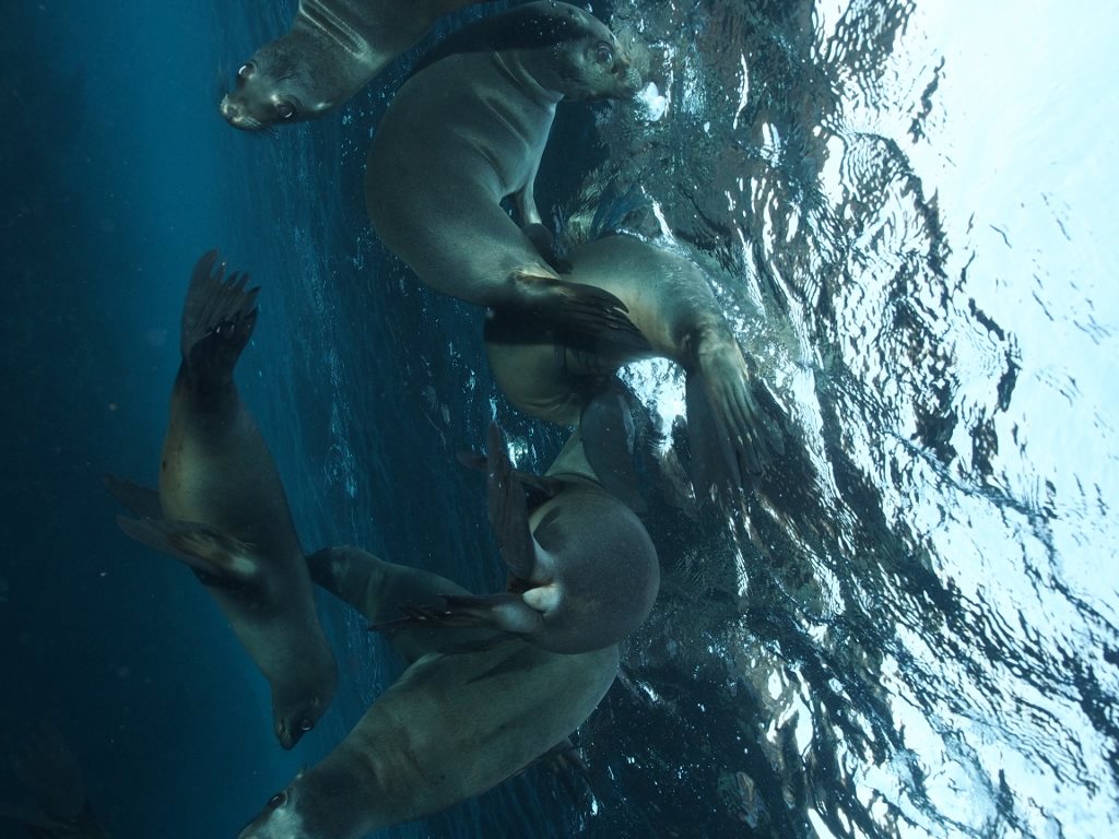

  10. Thanks Tom
    I freely admit that I am relatively new to underwater photography and basically fumbling in the dark with Lightroom. I use LR to record keywords, make minor adjustments and crop images. I then export those I want to share as JPEGs... The rest of the LR functions remain a mystery to me...
    The pixel count I gave above was from the JPEG files I created, one converted from RAW using Lightroom, the other using Windows photo gallery.
    Looking at the RAW image EXIF data in LR I note that the actual dimensions are 3456 x 4608
    On a whim I opened a RAW file using Windows Photo Viewer, made a JPEG copy which showed the 'missing' edges and then opened it using LR. The full height / width is now visible in LR and the EXIF info shows that the dimension count remains the same as the original RAW file.
    I then made some tonal adjustments and synced the settings to compare. Of course I find that the colours of the RAW file appear more realistic, but prefer the composition / wider field of view of the converted JPEG. There appears to be a slight change in the shape of the sea lion's head so perhaps LR is applying a lens correction which may explain the 'missing' sliver along the edge of the images?
    It's not a big deal, but as mentioned in my earlier post that extra little bit of space at the edges could make a nice shot even better.
    Was hoping there may be an easy fix which I could add to my workflow when importing and reviewing images.
    The mystery continues.
    Attached are a couple sample images to demonstrate what I described above.

  11. _alex_ said check/change the crop ratio in the CAMERA not in LR ;)
    Camera settings are 4:3 settings in LR were 4:3 as well

  13.
    My advise only works if you shot the picture with a 2:3 ratio. The RAW file will always have a 4:3 ratio.
    Most of the time I use the 2:3 ratio, since it saves me time editing. But when there is an "composition error", changing the setting in LR form as shot to original may save the picture.
