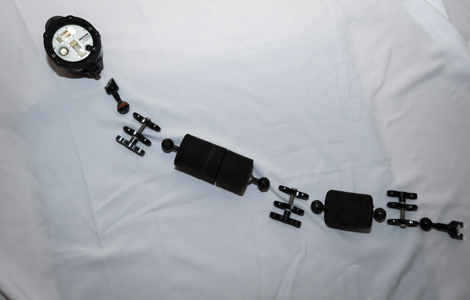

  9. I agree with giffenk on the clamps. Maybe this photo helps show a possible layout and connections. Normally I have the 5" arm closest to the strobe and the 8" near the housing
  10.
    You may have forgotten the photo ;-)

  12. You may have forgotten the photo ;-)
    Can you (or anyone else) recommend me a book on the basics of underwater photography gear? As an experienced "over-water" photographer, I'm quite familiar with the act of photography itself (i.e. exposure, shutter speed and the like), but I have next to no knowledge about clamps, arms, balls and so on.
    Heaven knows what has happened to that pic! And now I can't find it... was it a dream? Am I losing it??
    Will reload when I can find it!
    As for a book, have a look at Martin Edge's book The Underwater Photographer which is up to it's ?4th edition. It's a very good source of reference
  13.
    Here's the photo... darned sure it was there a while ago!
