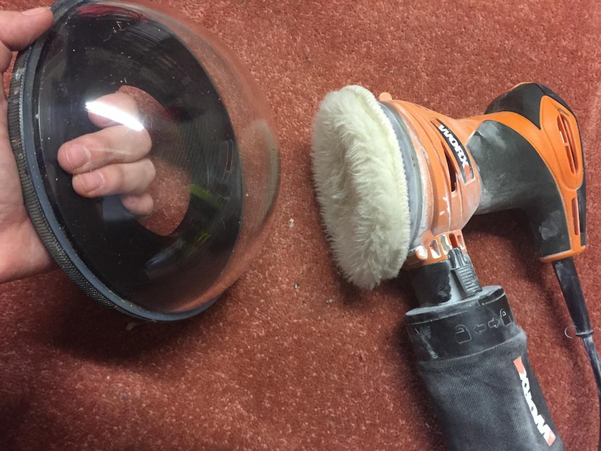

  1. A lot of my diving involves swimming through small spaces in the dark and I realised early on I was going to have a problem with keeping my dome port scratch-free. I chose an 8" acrylic dome port for my Aquatica because it was big enough for my rectilinear 14mm lens, small enough to fit through holes, and light enough to carry around. Easier to buff out and cheaper to replace were also considerations.
    After I got my first scratch I went and bought some acrylic polishing paste and polished it mostly out. Dive and repeat...after two years I gave up and bought a second dome port. The idea was to use the pre-scratched one for the difficult dives but since those were the ones I wanted the best photos from, it didn't really work and the second one rapidly ended up scratched. Before Xmas I tried this:

    4. Polish the least-damaged port again and deal with it...does anyone know how much acrylic you can remove before the depth rating starts to suffer?

    If the scratches aren't too deep, the headlight repair kits with sandpaper do fine. My friend took a razor to the top and bottom edges on his neoprene dome cover so it would go over more easily and stay on underwater. He just cut a groove to slip over the shade rings.

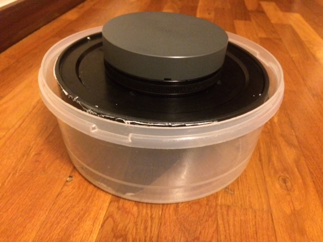

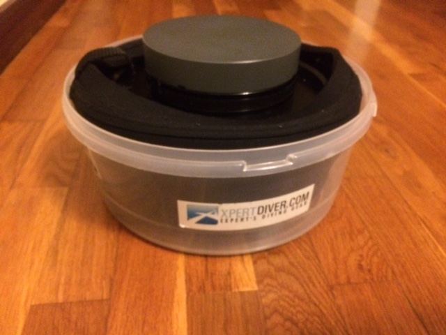

    For travelling, when I travel alone and do not have my wife to share her carry-on luggage, I need to check in some stuff. When that happens, one of the things that I put in the checked in luggage is the dome (the same one you have). I use for protection a “Tupperware-like” plastic container with the “right” size. I use it also when I put the dome in a box for travelling in the car with all the equipment or when the equipment is “resting” at home.
    I attached 2 pictures to show it. One with the neoprene cover and the other without it.

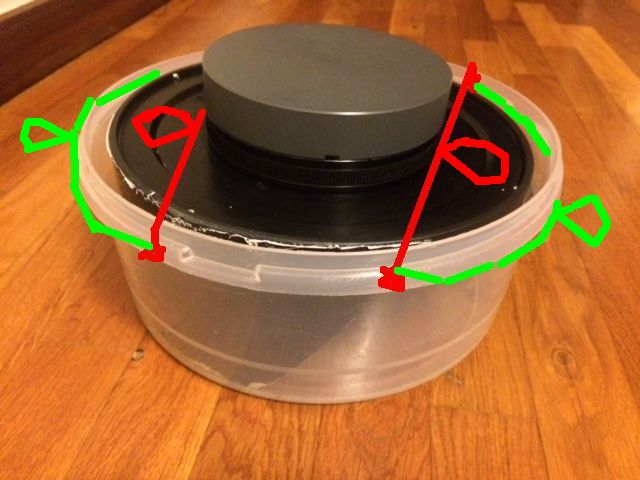

    With a small DIY project, you can use one like this to make an “hard-shell” to protect you dome when going through the narrow holes…
    If you make 4 small hole on the side and pass 2 elastic cords, you grant it in place, and make it easy to put it and take it. On red to secure the protection, on green how to place the elastic to take out or put the protection on the dome. You can make 2 small loops/knots on the elastic to make it easier to pull it either with gloves either with the housing (there is not so much space there).
    As you can see, the container I have is quite the same size the dome, it will not increase the size of the rig. If needed, you can make small holes near the from corner of the container to help release the water and air, but I would do this only after validating if they are really needed (as every hole you will put there, will reduce the overall strength of the hitec protection for your dome.
    Maybe it's time to try sandpaper instead of the Novus paste. I do like the orbital sander though - it made polishing heaps quicker! Not sure I'd be game to use it with sandpaper instead of the lambswool buffer.

  9. "Maybe it's time to try sandpaper instead of the Novus paste. I do like the orbital sander though - it made polishing heaps quicker! Not sure I'd be game to use it with sandpaper instead of the lambswool buffer."
    They use a handheld Velcro holder for the two grades of abrasive, 1000 and 2000 grit. I usually spend about half an hour carefully and evenly cutting the surface to keep it round before pulling out the drill and supplied buffing wheel and polish. You have to be really even or you'll flatspot the dome. My small dome comes from Bare and I can send it in for a new bubble if it gets really dinged up. He only makes them for Nexus, though, so I had to buy a Sea & Sea adapter for Nexus domes.
    This is a good point - sandpaper by hand and then speed up the polishing process with the power tool. Given the dome will be going past 100m, I worry about impacting the depth rating with repeated polishings. Having a dome implode with a bang on one of those dives would be a brown pants moment.
