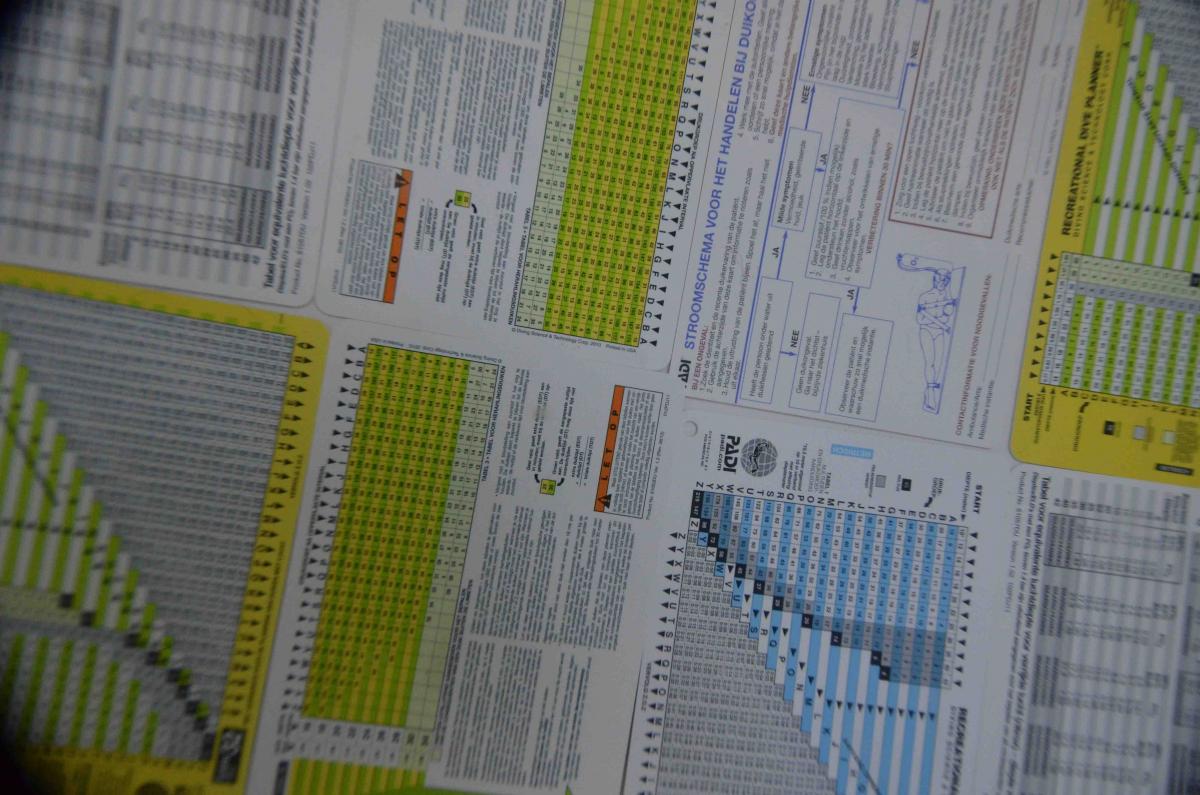

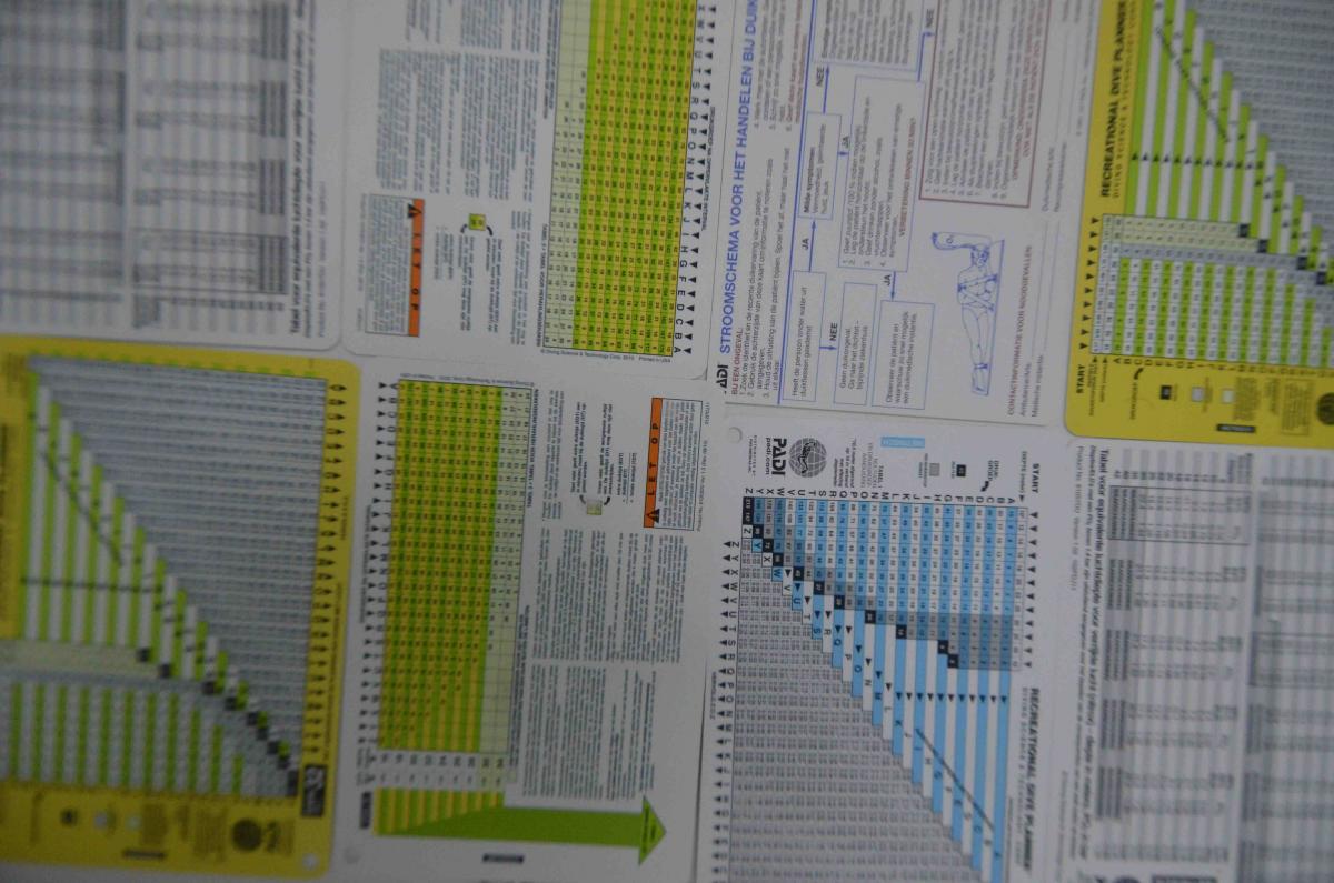

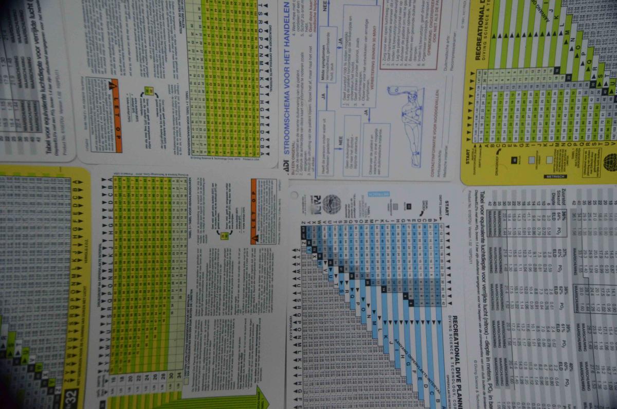

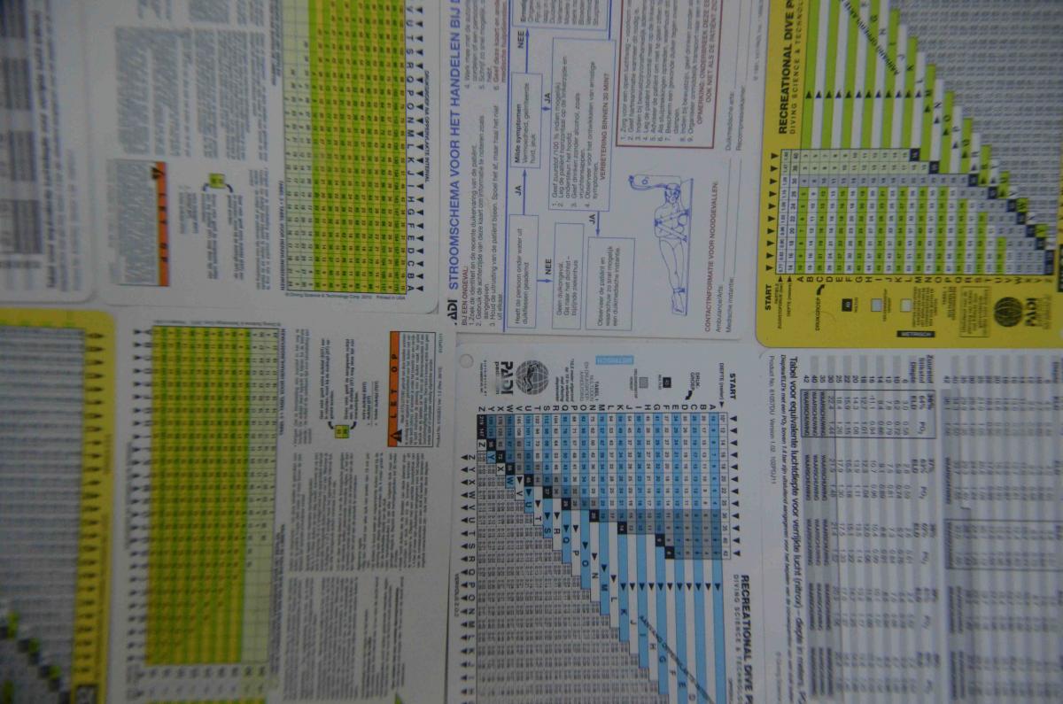

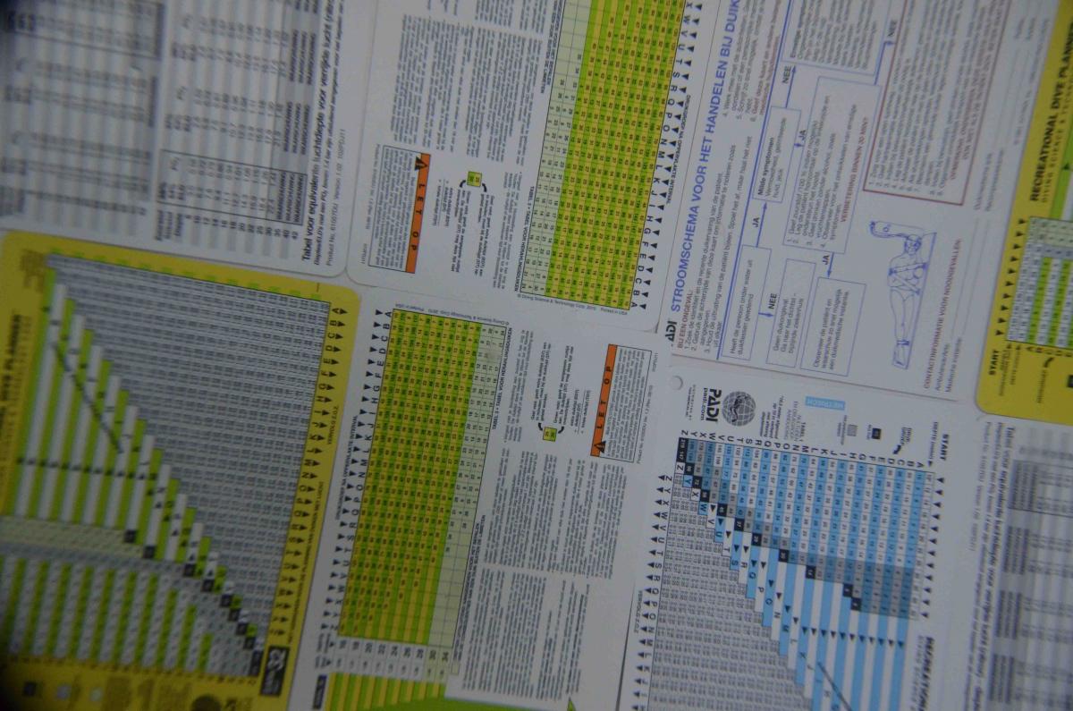

    For my Nikon D7000 in Ikelite housing I have so far used a Tokina 10-17mm fish eye lens. I recently bought a Nikkor 12-24 mm to also capture skittish pelagics. However, I have problems getting sharp corners when using this lens in combination with my 18" dome port. To summarize, I can neither get sharp corners without any close-up lens, nor with any of the close-up lenses I tried (B&W +2, B&W + 3, Hoya HMC +1 and +2, Canon 500D). Vignetting was significant for the Canon and Hoya filters. For now, I will not even consider chromatic aberrations; I simply cannot even get sharp pictures. Now, I actually don't know how to solve this problem.
    To test, I took some pictures in my bath tub, without filter and with all the filters mentioned above. For all cases I took photos at 12mm, 18mm, and 24 mm. Please find the 12mm results below.
    This is without the filter:
    Here, the result with the B&W +2:
    the B&W +3:
    the Hoya +1:
    the Hoya +2:

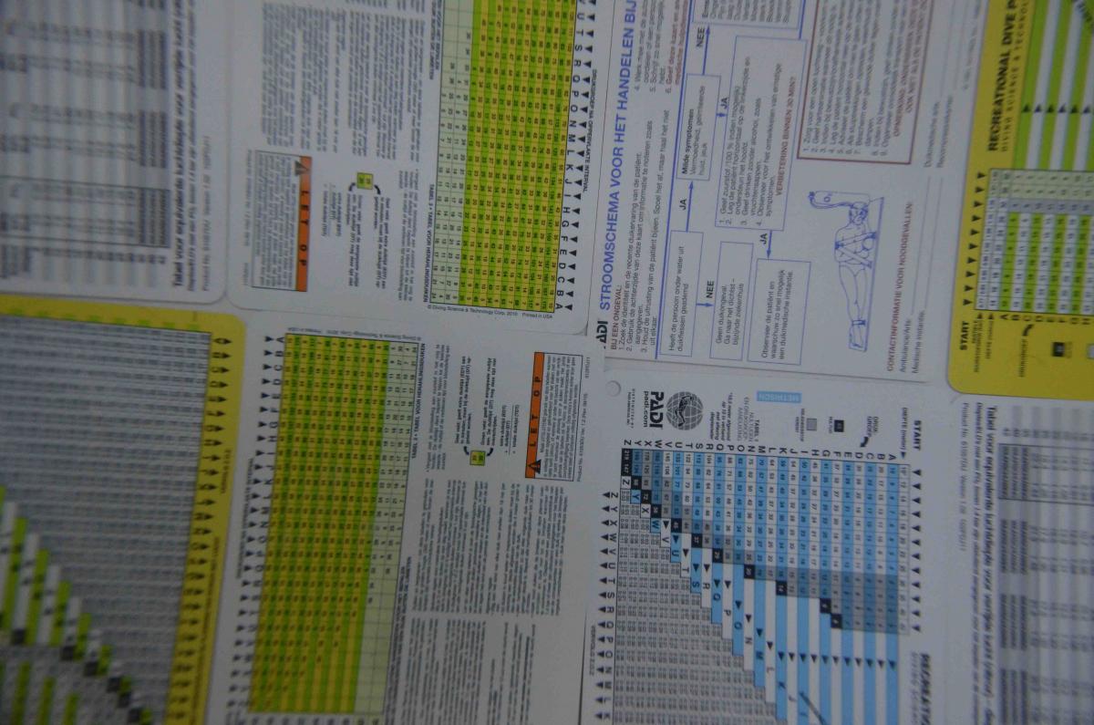

    and I'll have to put the result for the Canon 500D in the next post.

  2. with the Canon 500D:
    As you can see, none of them give very sharp corners. In my opinion, the B&W +2 gives the best overall result. Some of the other filters also result in curvature near the corners, and the Canon filter shows serious vignetting (although the Hoya filters are also pretty bad in terms of vignetting at 12mm).
