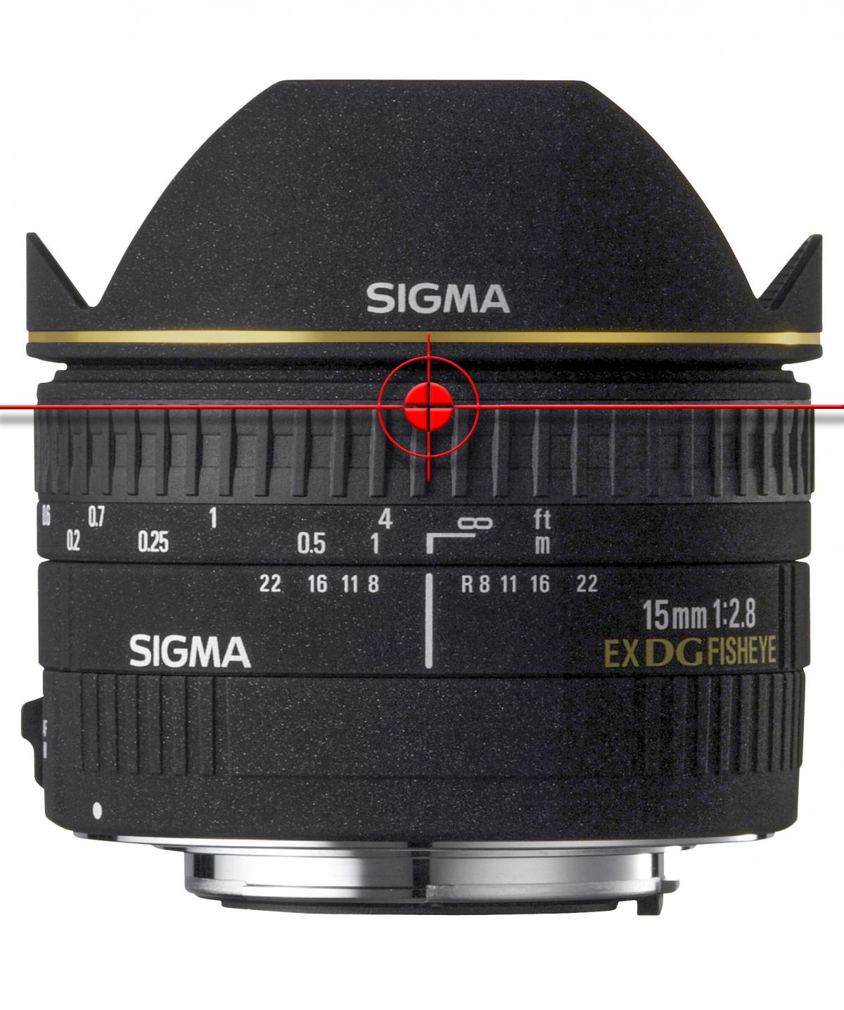

  5. Hello PeteAtkinson,
    I do 360 panoramas with a Nikon D810 and I use the Sigma 15mm. I measured where my 'No-Parallax_Point' is on my lens and it is 37.5mm from the rear of the lens. (where the lens mates flat against the camera body) I have attached a photo with the spot marked in red. To be clear, this is the point around which the camera/lens pivots to eliminate parallax. I hope this helps.
  6. This helps a lot! And it shows why I need to ask, as my measurements are so bad, and yours, and Simon K's are virtually the same!
    Many thanks to both of you. If you have NPP measurements for other lenses used underwater Randall it would be great if you could post them on Wetpixel where they should be pinned. Thanks again!
