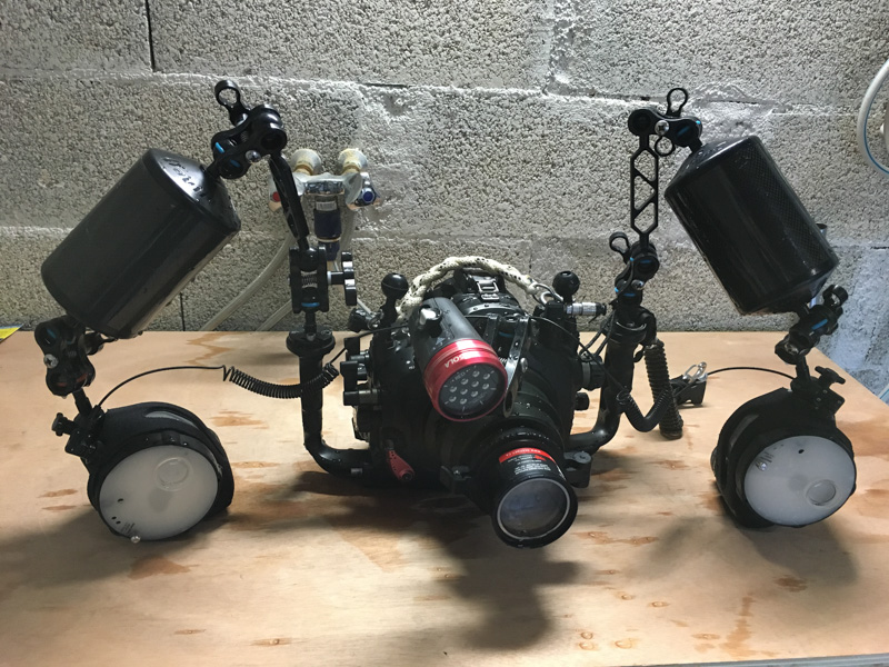

    Now (2016) i am moving to a Nauticam DSLR housing (NA-D300s), complemented by my 45 degrees viewfinder.
    Photo here:
    When shooting with 60mm macro + focus light, i don't have adequate equipment to make my rig neutral:

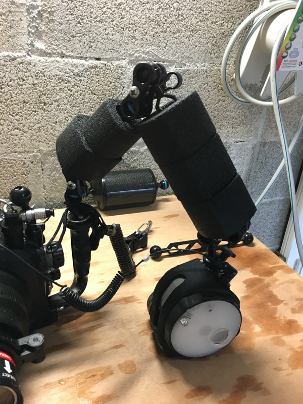

    -my 2008 setup with Stix floats doesn't provide sufficient buoyancy, but i felt it provided great comfort in strobes repositioning. I tested it yesterday. Here's how it looks like one one arm:
    -my 2013 nauticam float arms make the housing (too much) positive

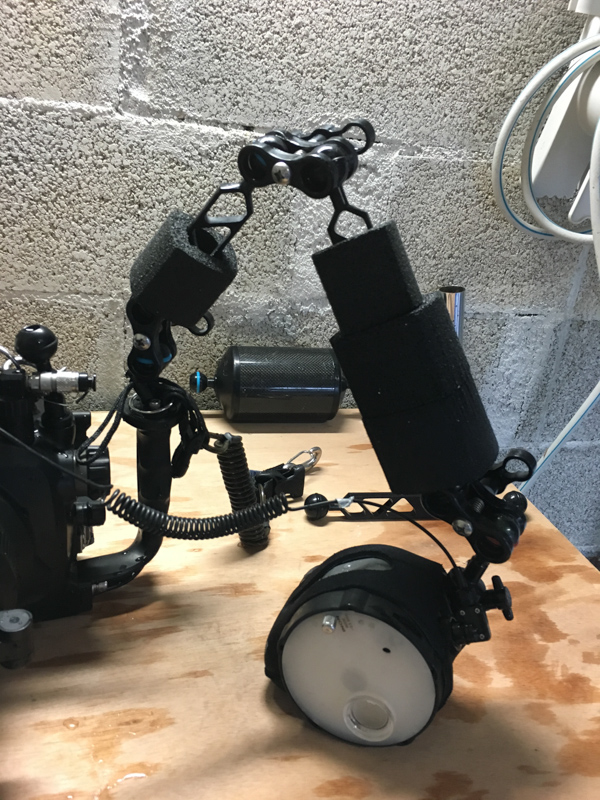

    One idea i have is to buy 4 extra jumbo Stix floats, and add them to my ULCS strobe arms (2x 8" and 2x4"), replacing some of the large floats possibly. I tested (on land) that i could squeeze 4 jumbo Stix floats on a 8" ULCS arm + 1 jumbo & 1 large Stix floats on the adjacent 4" ULCS arms, and this would bring extra buoyancy, hopefully enough! Here's how it would look like on one arm:
