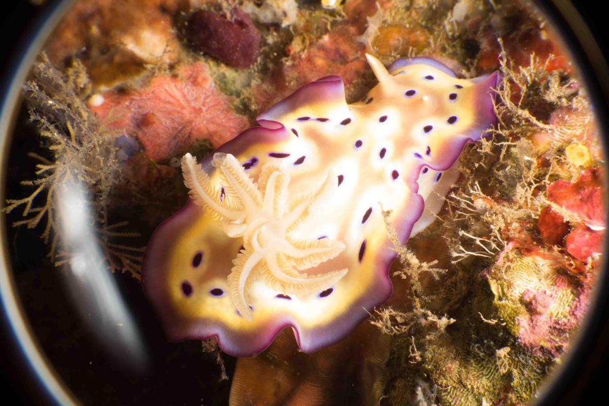

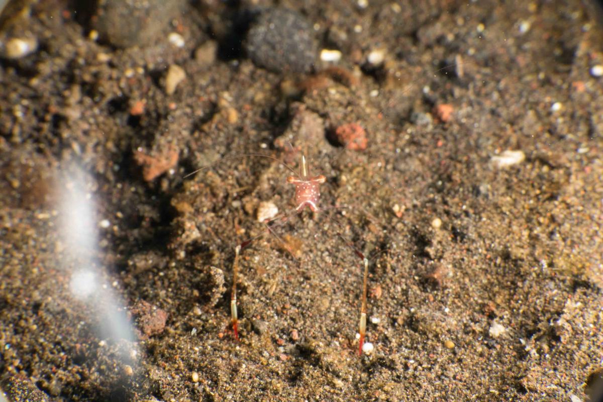

    I have a Canon G16 with a Nauticam housing and recently acquired a Nauticam Compact Macro Convertor 1 as well as a single strobe Inon Z240.
    I am hoping you can help me with some questions I have using the CMC-1.
    1. Circular mark in corner of pictures (please see pics attached)
    Every time I use the CMC, a bright circular shape appears in the corner of my pictures. Would you know what is causing this? Could it be the position of the strobe which is reflecting on the lens?
    I have to be very close to the subjects when I use the CMC and need to point the strobe very close to the lens. Could that be the issue?
    2. Distance to subject
    How close are you supposed to be to the subject when using the CMC-1 with a compact camera? I usually have to be about 1 to 2 centimetres close which I find too close. What do you think, is this normal?

  2. Try moving the strobe back, so it is not in front of the camera.

  4. When using a macro diopter, it's common that you would zoom all the way out to get the most magnification. In the photos you posted, if you zoom all the way out, you could easily fill the frame with the whole creature. Remember, when come to macro, it's about getting close. Depends on the subject and their size, 1-2 cm is reasonable.
  5. When using a macro diopter, it's common that you would zoom all the way out to get the most magnification. In the photos you posted, if you zoom all the way out, you could easily fill the frame with the whole creature. Remember, when come to macro, it's about getting close. Depends on the subject and their size, 1-2 cm is reasonable.
    The problem when I zoomed out is that I had a "black tube" appearing on the outer parts the images. Would you know how to avoid that? I am using a flip diopter holder.

    Can you add a picture of this, Helene? Is it a reflection?
  7. Sorry, I mean zoom IN, use the longest focal length.

    Hi,
    Attached is a picture using the CMC when I do not zoom in. A "black tube" appears in the picture.
    Are you always supposed to fully zoom in when using a diopter?

  9. I see two issues:
    First, you need to zoom in further (longer focal length) to eliminate the vignette. The wider focal length is picking up the CMC body. You can easily test this on land.
    Second, it looks like the strobe is indeed causing a reflection. Remember that the strobe puts out a cone of light. You don't want that cone illuminating the front of the CMC. Aim it more forward, and if possible place the strobe behind the front of the CMC.

  11. The G16 has 140mm equivalent focal length this is very long.
    According to Nauticam chart you should be able to work at 59mm distance. If you are closer it is likely you are zoomed out
    The G16 with CMC achieves 19mm frame width which is good for pygmy seahorses but for the majority of subject is too strong
    For example you should be shooting the detail of the nudibranch if you try to fit it all in the frame and zoom out you end up on the edges of the lens
    Looking at the picture it seems like the strobe is on the right side as the shadows are on the left and is going through the lens creating reflection
    Can you look at the exif and post the focal length of all those pictures?
  12. Also keep in mind that you don't want to use the CMC for every subject. For example, that last shot of the nudi, you probably didn't need the CMC and could have shot it with the lens zoomed in, whereas using the CMC caused you to have to zoom out but then you get the vignette. With your camera, you probably only need the CMC for really small critters or really tight details on larger critters.
    When I shoot super macro, I almost always have the strobes pulled in very close to the port, a little (like 10 cm) behind the glass, and aimed straight ahead, or even a little outward from straight. If you were looking straight down on my rig from above, the strobes would be pointing like the outer legs of the letter "W".

    Your lens is zoomed out. The G16 range is 6.1-30.5 you are at the wide end close to the vignetting point. Closer to the black vignette the lens has another glass area not clear it is likely this is your reflection.
    Because you are not zoomed out the camera working distance is around 1cm so to go further away you need to zoom fully.
    Frame width 19mm means anything bigger will not fit the frame
    In short I do not know who advised you to get the CMC for the majority of subjects you will achieve less than the traditional macro frame width of 35mm with a single Inon UCL-165 so unless you live in pygmy seahorse land the CMC will be too much for you and a weaker lens could have been sufficient.
